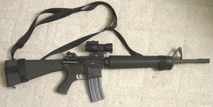

    This rifle started out as my first build. I built it back in ’96 or ’97 during the ban on a Bushmaster lower. The initial build was your standard post ban A2 build:
    • Bushmaster Lower
    • Bushmaster 20” 1:9 Chrome lined HB—no lug and not threaded
    • J&T A2 Parts Kit
    In 2004 when the ban ended I was in the middle of an FAL build and took the FAL barrel and the Bushy barrel to a local machine shop to have both cut to 18”, threaded, and the AR barrel lightened under the HG’s. At the same time, I switched out the A2 upper to a flat top and added an Aimpoint Comp C 4moa.
    Here’s what it looked like:

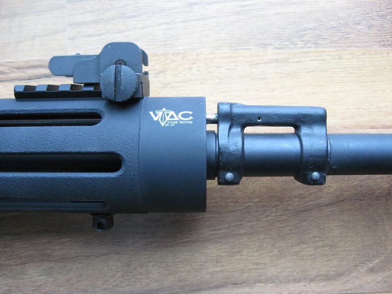

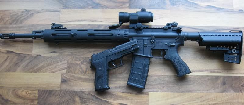

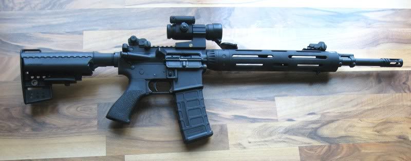

    Build as before and added:
    • Shaved front sight
    • Viking Tactics VTAC tube
    • YHM front and rear BUIS
    • VLTOR Clubfoot and Mil-spec buffer tube
    • Standard Carbine Buffer
    As it is now:

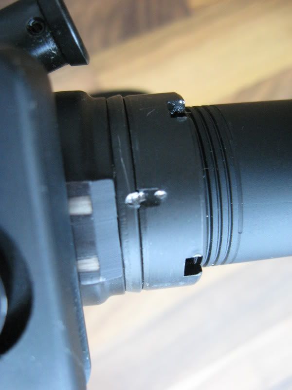

    One question I’ve got—This is the first time I’ve installed an adjustable stock. Did I stake the Castle Nut sufficiently?
    damn, dude.. you steak it with an IED? you want to just dimple the metal, so that it swells into the gap, rather than erupts into it. but that will hold..

    Quote Originally Posted by bkb0000 View Post

    IED? That's for amateurs! Dad and his brothers used to prospect a fair amount with their Dad. My uncle has the real stuff to use out on the old mine claim.
    Actually, the end plate had been staked before. I bought the stock as complete assembly. It had been installed and lightly used. When I put it on my rifle and tightened it down the prior staking marks lined up right where I needed new staking. I used a punch and displaced metal as you can see. Due to the old marks, to get the displacement, I had to do what you see. The staking on the side isn't as rough in appearance.

    Looks good to me. The Bushmaster end plates are pretty damn hard. So hard that it makes staking well kinda hard unless you're using a spring loaded punch.

    Quote Originally Posted by usp_fan View Post
    i was basically just flicking you turds. i've actually had to resteak the same spot myself, and it does get messy. how's she shoot?

    Gotm4: VLTOR end plate. Came with the stock kit. Seemed kind of soft--hence the blow out.
    Well then yes the VLTOR ones are soft. It only takes 2-3 hits from a spring loaded punch to stake them really well.
