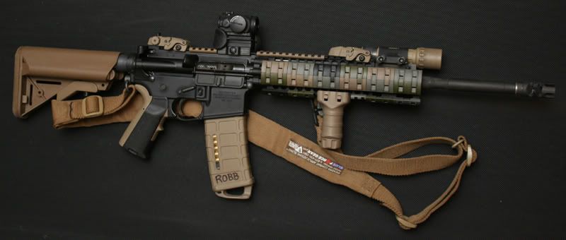

    I am running one on a Colt 6920 with a 16-inch barrel. The only thing I have noticed is that it does not hide the flash as well as a friend's Smith Vortex.
    But it was never designed to.
    It does basically eliminate any muzzle rise. None. Nada. Zip. Zero. Zilch. That is what is is designed to do, and does quite well. I get a slightly-faster followup on my second shot.
    And it still more accurate than my tired old over-50 eyes can shoot.
    I would ask gotM4 (Robb) what he thinks. He installed the PWS556 on mine, and it's ever so sweet.
