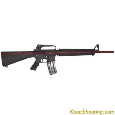

    From what I understand, it was designed to raise the iron sights to eye level. Since the Stoner design places the barrel, breech, and stock in a straight line, it was needed to raise the sight plane to where the shooter's eye would be.
    I could be wrong, but this is what I have been told.

    The buffer tube placement required the sights be mounted high above the bore.

    No, not all rifles are like this. What I mean is that the muzzle, barrel, receiver, and stock are in a straight line in the AR-15 and variants.
    This is not the case in most rifles. Think of the AK47. It's muzzle, barrel, and receiver are in line, but it has a stock that angles downward.
    This angle, which places the line of the barrel above the line of the stock (to raise the barrel to the shooter's eye), creates more muzzle rise when firing than does the AR-15. Stoner's design significantly reduced the muzzle rise, especially when firing on automatic, by putting it all in line. The recoil comes straight back, instead of back and downward.
    Hope that clears it up.

    The AKM and AK -74 have a straight buttstock.
