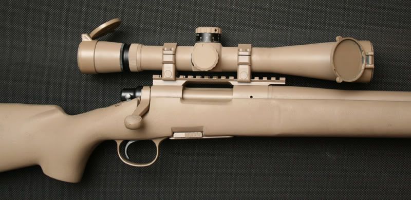

    I'm using a 20MOA Badger base and Badger medium 30mm rings. I have a Leupold 3.5-10x Mk4 scope.
    Actually I just sprayed my mount and rings with FDE Norrells moly resin the morning and the Butler Creek caps with Duracoat Magpul FDE.

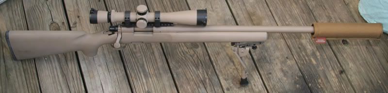

    This is two pics of it before painting the scope caps and rings/mount.
    The barrel, receiver, bolt and suppressor are sprayed with FDE Norrells and the stock, scope and bipod are with Duracoat tactical dark earth. The nomex suppressor cover is from www.riflesonly.com

    I bought it at work, I work in a gunstore. I see what Pk14 is talking about. If I later go with a 50mm Leupold or Nightforce scope (I want a 5-22x) I would likely have to shorten the front edge of my Badger base. This easily done now that I have access to two milling machines.
    Here's what my beast looks like after the Duracoat on the scope caps and the FDE Norrells on the rings and base.

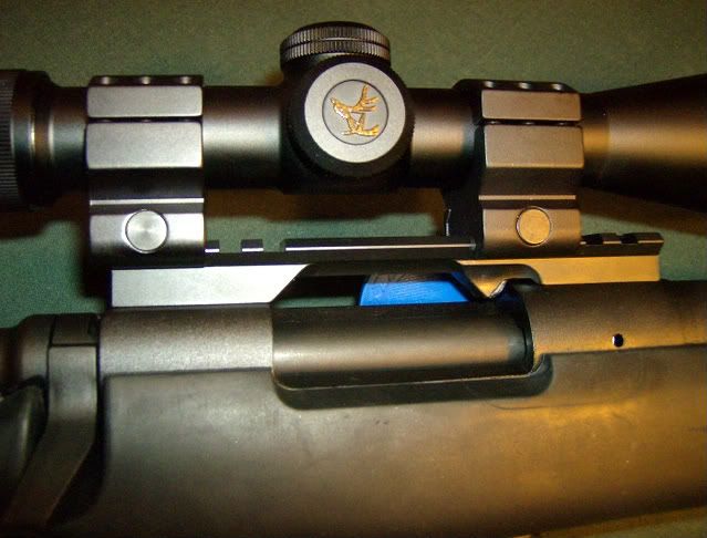

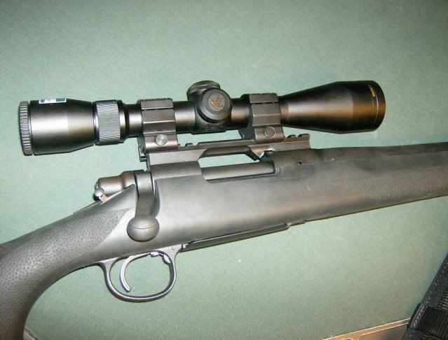

    Here are a couple of pictures - there's enough adjustment fore and aft with the Burris rings and the Farrell base to handle a fairly wide range of scope / shooter pairings. Hope that helps.
    Pk
    Closer shot

    Thanks for the pics Pk. You sure have that rear ring mounted as far back as possible huh?
    I believe I am going to go with this setup and save a little money from my initial thoughts.
