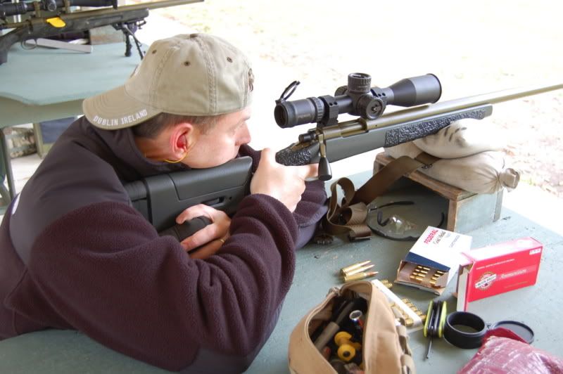

    I shot the Premier at 15x with the mildot reticle next to a loopy 20x and my own NX with the MLR reticle. I prefer the NX MLR for a reticle but the quality of the Premier was more than noteworthy. I only put a few rounds down range with it and spent only about 10 min behind it. Fantastic overall impression and they will be getting my money from now on.

    My rifle is in the background. A friend had just received a new rifle from Tactical Operations and we were testing some different glass on it.
