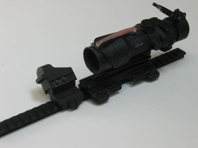

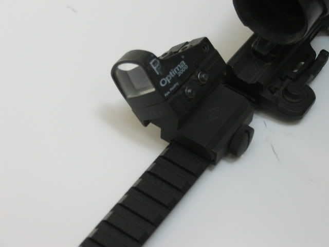

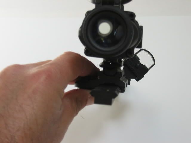

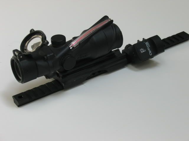

    Here is a way to mount a MINI red dot in conjunction with an ACOG. Pictured here is my TA-31 and an old Optima 2000 using a YHM 45 degree offset Rail. It is a simple solution and in my opinion requires the least amount of cant to see the MRD. I have a Daniels Defense off set mount as well and this puts the MRD closer than the DD mount.

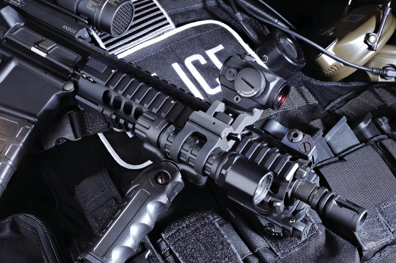

    Jul 2006
    USA
    130

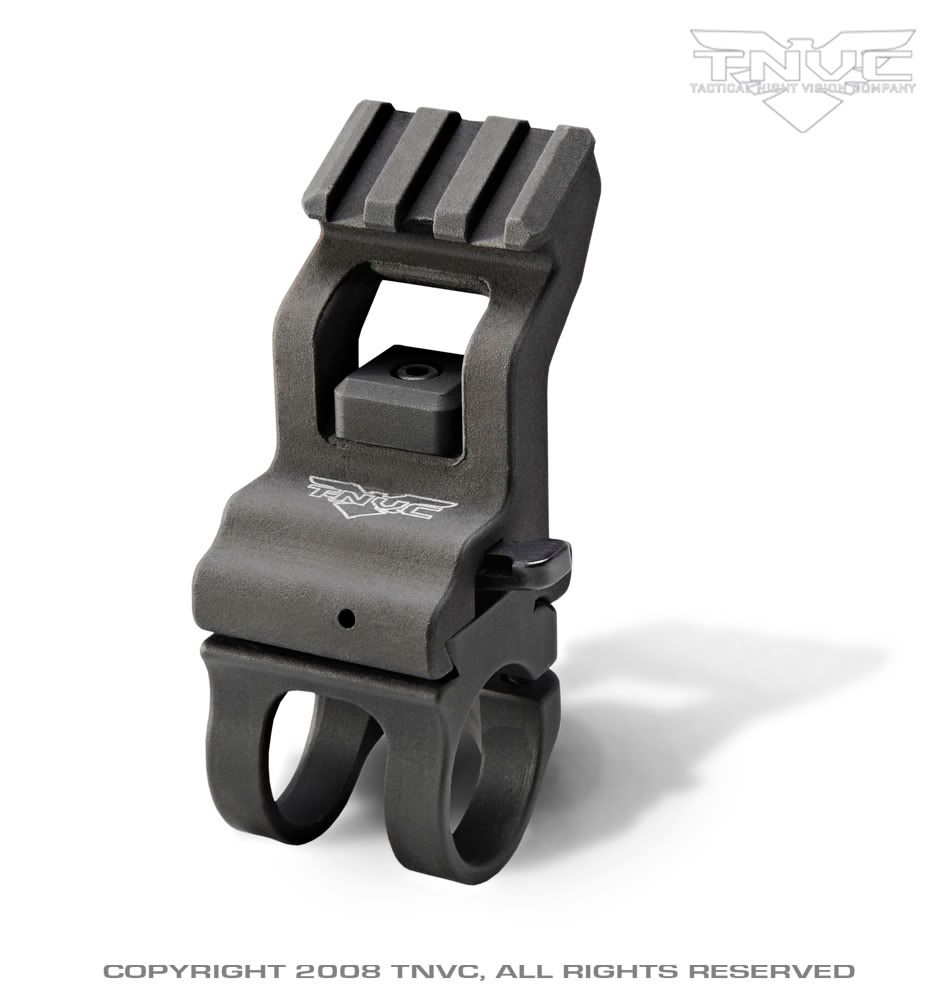

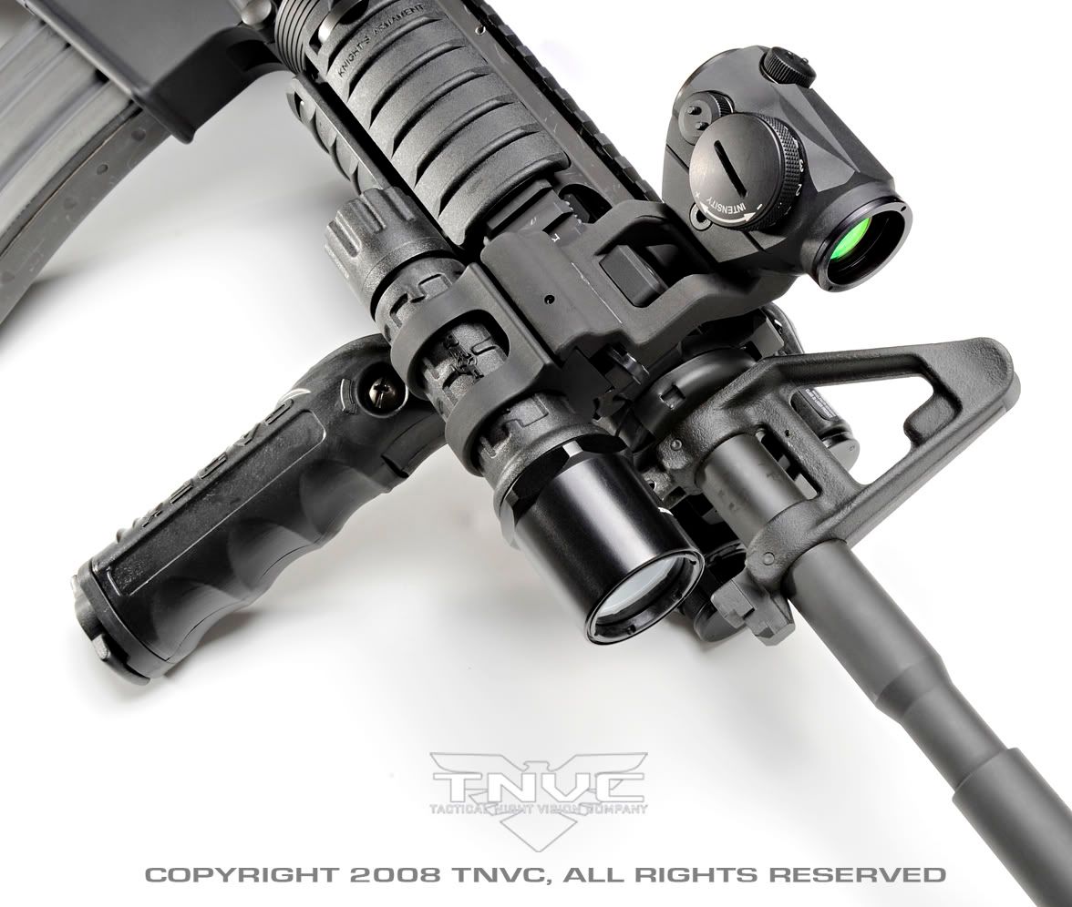

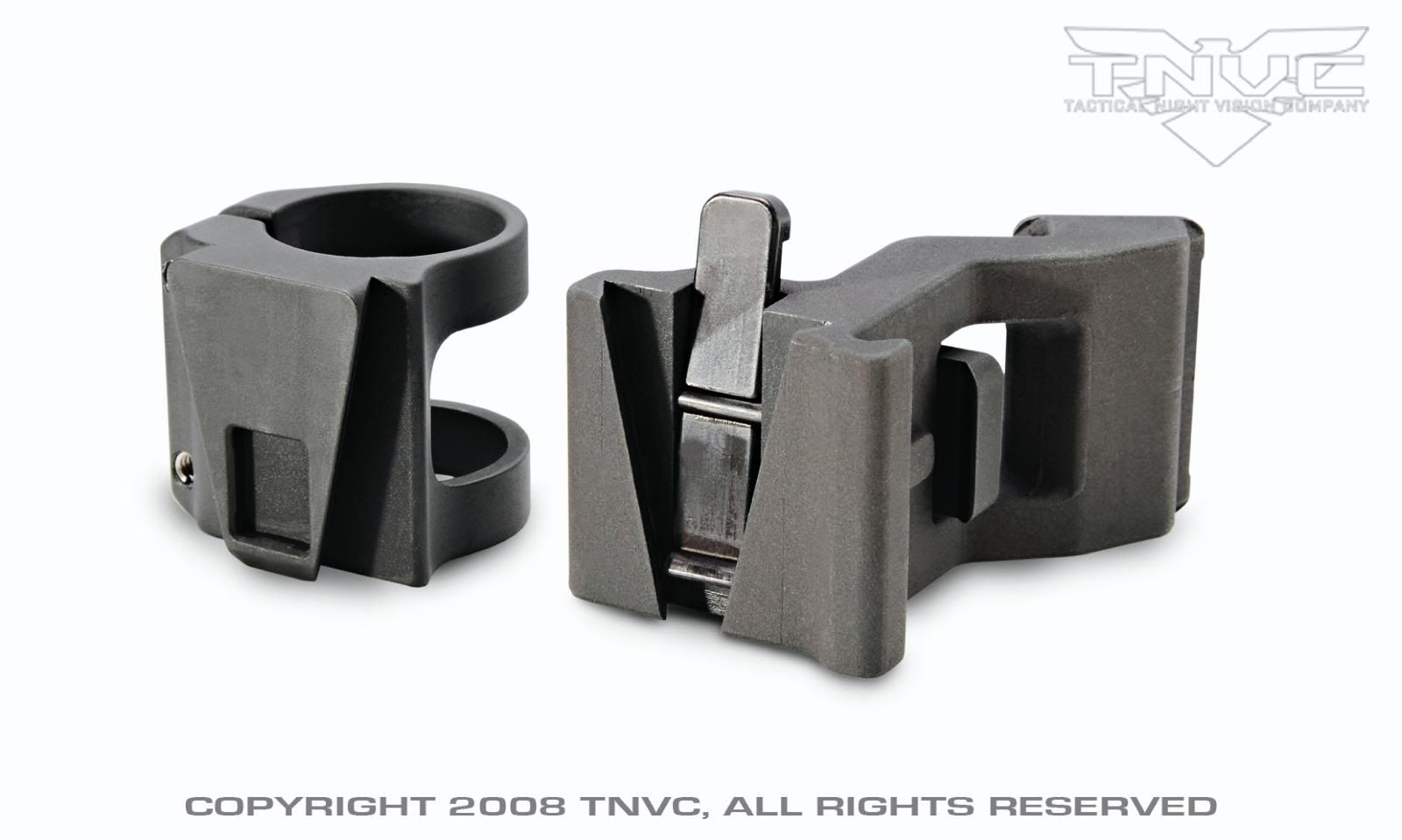

    This is the exact application that the TNVC MURLM (Multi Use Rail & Light Mount) was designed for. The MURLM mounts a mini red dot at a perfect 5 degrees off the site line. This allows you to pick up the dot with the most minimal cant of the weapon. Most guys that first get their hands on the MURLM end up way over-canting the weapon. In fact, some guys just shift their eye over and pick up the dot. Either way, you maintain your cheek weld.
