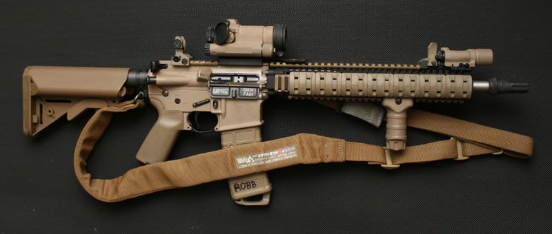

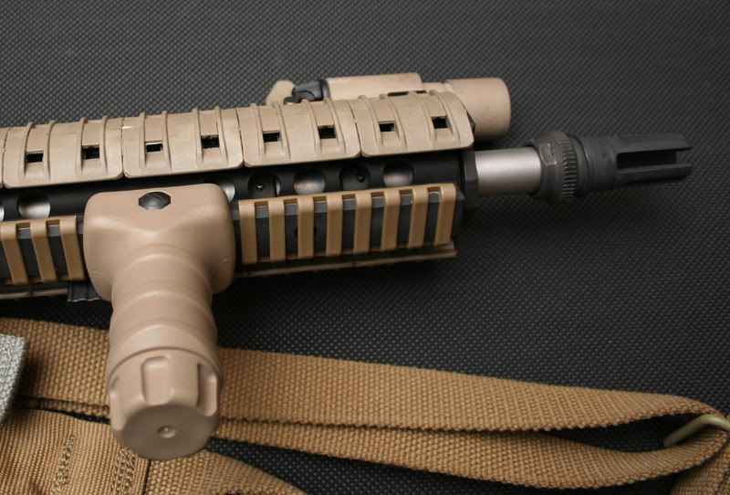

    DPMS lower, CMT upper, PRI Gasbuster charging handle, BCM bolt carrier, LMT enhanced bolt, CMT H buffer, LMT SOPMOD stock on LMT receiver extension, RRA stainless 1x8 middy turned to .700" between the chamber and gas block shortened to 14.5" w/shaved FSB and chambered reamed with 5.56mm NATO neck and throat reamer (was a .223 Wylde chamber), Daniel Defense 12" RIS II M4A1 rail, Aimpoint M4S in a Bobro mount, Troy flip up sights in FDE, Surefire X300 light, Magpul MOE grip and rail covers, Tangdown stubby grip w/ADM lever, Vickers 2pt sling from G&R Tactical w/sewn on QD loops with Daniel Defense mounts.
    I shoot the rifle with a suppressor sometimes so I use a H buffer. The gas port was not enlarged after the shortening. If I didn't ever use this rifle with a suppressor I'd use a CAR buffer.
    I shoot everything through it from Wolf 55gr to Black Hills 77gr MK262 Mod 1, it's works well with everything.
