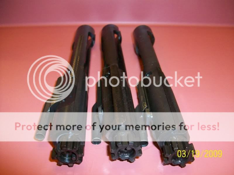

    The entire BCG is reversed on the stag. Everything about it is reversed.
    This is a picture of my Stag 1L BCG (Left) and pictured on the right is my Charles Daly Defense.

    216

    Could you take a picture of the bolts side by side?
    I'm on a learning mission here
    I'm thinking that the difference can be found in how the bolt cam gets inserted.
    On the standard version there are two indents around the hole opposite of where the bolt cam goes into; are these indents on opposite sides???

    Honestly, I did forget my camera on my desk at the office, so I'll get it for you tomorow. I'll take different angles for you side by side of the CDD vs the Stag lefty.

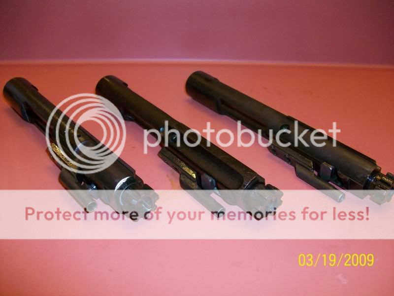

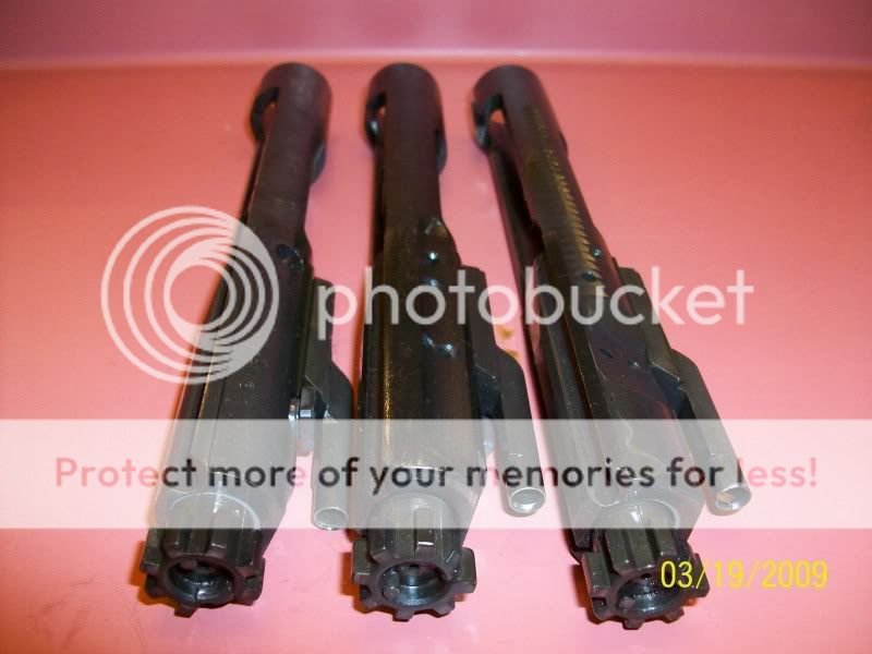

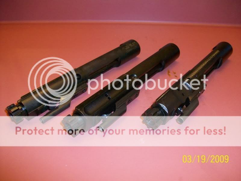

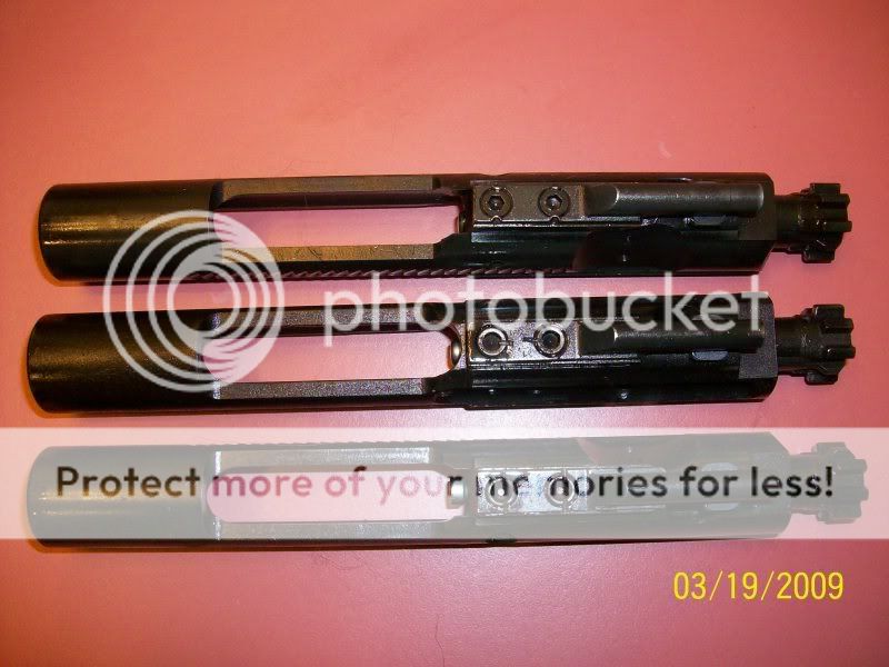

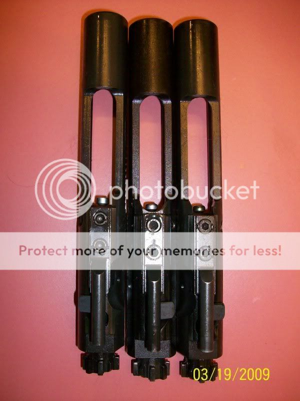

  10. #40
    Nov 2008
    Pittsburgh Area, PA.
    869
    Smuckatelli,
    Here is what I think you wanted. If you wish for them to be taken apart and pictures taken again, I can do that as well.
    Each picture is Stag 1L on the left, Bushmster Carbon 15 center, and Charles Daly on the right. This will be consistant in this set of pictures, only the position in relatin to the camera angle will change. I will appolagize up front for not being StickMan... and for having rose colored counters in my bedroom bathroom!
    Once again, if you need to see more, I can do it. The fireing pin and cam pin are interchangeable. The Bolt and Bolt Carrier are reversed to place the cam pin on the opposite side.
    I save money using AMSOIL full synthetic lubricants. Do you?
    http://www.lubedealer.com/DiscountPowerParts/home.aspx
