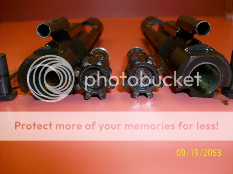

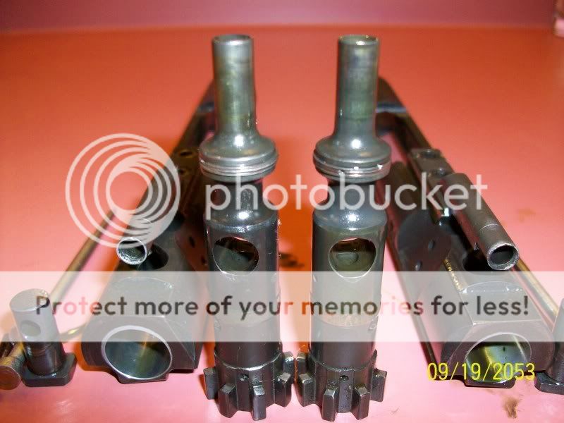

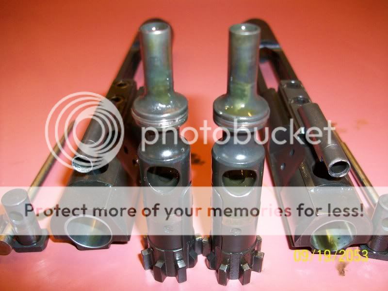

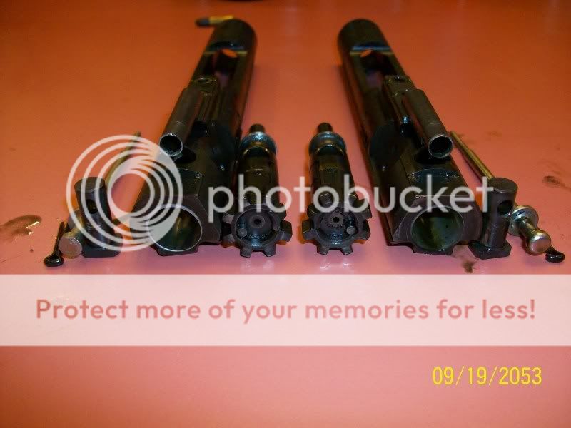

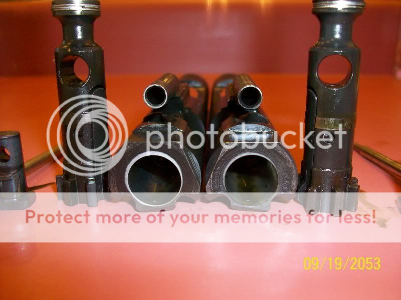

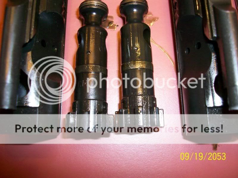

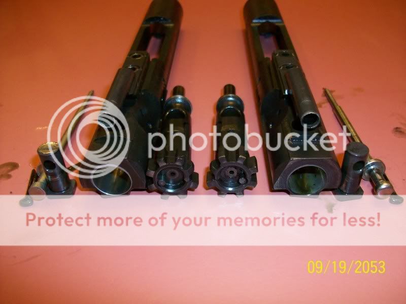

    Never again will a man ask for pictures of a Stag Lefty BCG or its internals. Aside from the extractor, it is now officially done and can be found in any search.
    Stag Left BCG on the LEFT, and a Charles Daly Defense standard on the RIGHT to compare with.
    I turned and rotated and tried to get a couple angles to allow you pick up on whatever it may be your looking for.
    Cam pins are interchangable. Firing pin lock clip is interchangeable. Firing pin is interchangeable. Extractor is interchangeable. Only the Bolt and Bolt Carrier are NOT INTERCHANGEABLE between a Stag left hand version BCG and right hand version BCG of any manufacturer.
    Thats it, Fort Pitt! (Pittsburgh saying for "it's done" or "It's over")

  7. #47
    Mar 2009
    Stafford, Virginia
    1,169
    Perfect!
    The bolts themselves appear to be the same EXCEPT the hole were the bolt cam goes in.
    Great pictures.

    The bolt, when positioned so that the cam pin will insert straight down from the top has the extractor on the opposite side. If you look at the following picture, these two bolts are in the upright position just as they slid out of the bolt carrier. Notice that the hole for cam pins are both straight up so that you can see the off-set of the extractors.

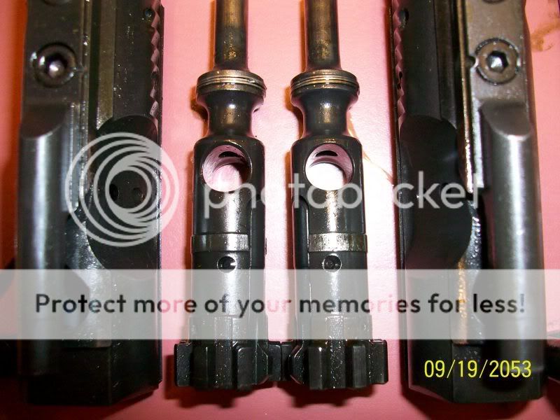

    Again, same picture of cam-pin hole upright and showing the extractor is reversed on the left vs the right:

  9. #49
    Mar 2009
    Stafford, Virginia
    1,169
    Quote Originally Posted by larry0071 View Post
    I see what you mean, I don't know the technical terms but I think what they do is use a standard bolt but drill the bolt cam hole from the opposite side....does that make sense?
    That makes perfect sence, except that they did also relocate the drift pin for the extractor. Notice it stays in the same position relative to the cam pin? Both the cam pin hole and the drift pin hole are moved in the lefty.
