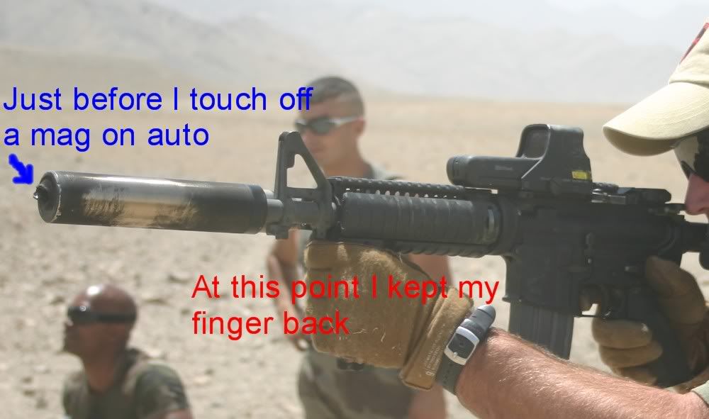

    Longer bullets are generally more likely to have baffle strikes that shorter.
    TRACER bullets are much more likely to have baffle strikes than FMJ or OTM's.
    Cans on short 5.56mm guns errode the baffles much more quickly than longer guns, even on semi-auto. If you are a non governmental suppressor user, you want to use a mount that has a intial blast baffle built into it, as depending on construction this can double or triple the life of your can.
    I've blown out several cans in my day
    Out at the range in Afghan, we took a bunch of pics one day.
    I've got some pics of KAC, Gemtech, OpsInc, Br-Tuote, Brugger and Thommett etc. cans that I or co-workers have blown.
    The KAC we damaged at work, shooting a NT3 on a Stoner LMG Short Barrel, a M856 tracer did a U turn down the pipe and an unpleasant end cap strike occured.
    Worst suppressor issue I have seen was a B&T SOPS M4 can that literally detonated and several onlookers took shrapnel off the can body . B&T admitted shipping a defective bunch of cans later, but one of the guys wife's who was on looking still had a 15 stick cut in her face...
