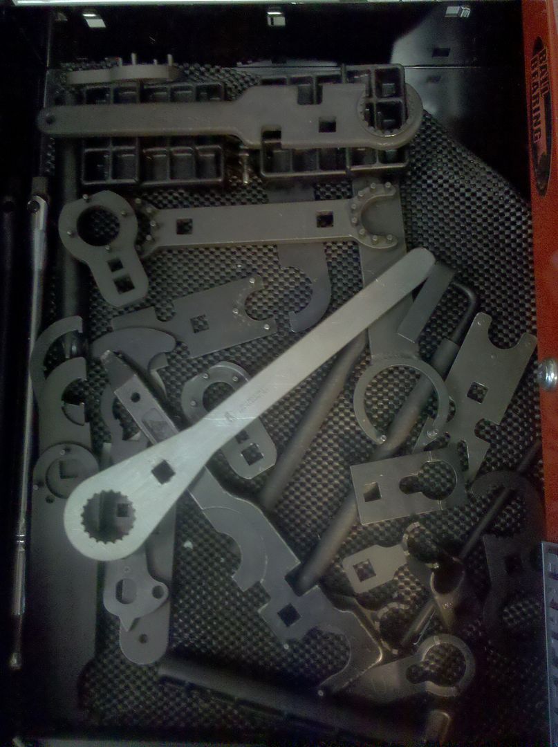

    The US Training Center one is quite good. Charlie and Eric at USTC are excellent instructors. An Armorers course isn't a gunsmithing course. Many LE dept armorers don't even change barrels, many just buy barreled uppers. A few local depts here in NoVA have had me work on their rifles. I think mostly because even though they have armorers most don't know what they're doing.
    The US Training Center AR15/M16 Armorers course is far better than the Bushmaster Armorers course. I think many of these courses don't teach barrel replacement because of liabilities etc and because of the many different types of rails, barrel nuts etc. This is one of those things that would probably require another 1/2 to a full day in class to cover all the methods and barrel nut types etc.
    Look how many types of barrel wrenches I have....in that drawer: DPMS, Smith Enterprise, Daniel Defense AR15 Lite Rail / 762 Lite Rail, PRI for 5.56 and 7.62, VLTOR, Colt 6940, FF-Bloop Tube, YHM, AR10, KAC SR25, USGI pre-A1 and A1/A2, Troy TRX.
