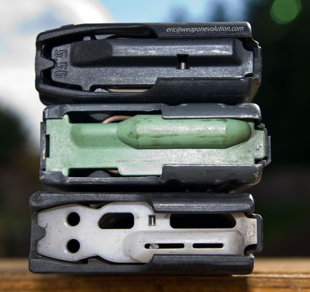

    A pic of the unusual follower (bottom), shown with a Pmag and USGI mag. I'm curious as to why the ARC feeds from the opposite side.
    Why would it matter?

    Follower
    I read that the TD mags have the "bump" on the follower on the left side so that when the bolt locks back on an empty mag, it's easier to see that the mag is empty.
    Not sure if that is so, or not.
