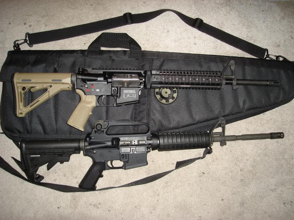

    Parts I used:
    Spike's Tactical stripped lower
    Stag LPK
    MagPul MIAD
    MagPul CTR
    LMT Buffer Tube
    LMT Castle Nut
    Brownells End Plate
    Wolf Spring
    H Buffer
    LaRue DMR-16 upper receiver (I thought about building my own upper, but being this is my first time, I decided to focus on just doing the lower.)

    Kaiser,
    You might want to stake those endplates/castle nuts. At least one of them looks as if it isn't.
  5. #15
    Republic of Texas
    854
    Kaiser,
    It is not as of yet. I know I will have some fine tuning to attend to since this is my first . . . anything else missed?
