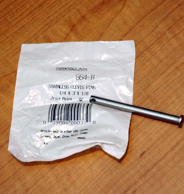

    1/4" clevis pin and a punch will work just as well as the expensive tool.

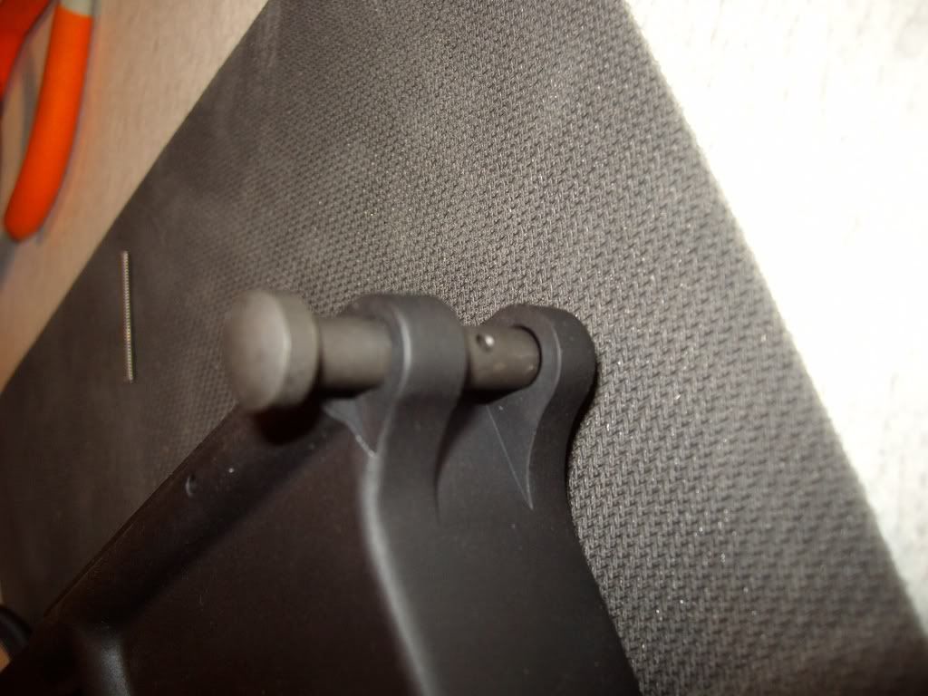

    i did my last one by using a pin punch to shove the detent (with spring) far down past the "drain hole" pictured here:
    that tiny hole off to the left
    then i used a 1/16" punch to hold the detent back by putting the punch into the drain hole (holding the "loaded" detent). put the pivot pin in and let the detent go into the detent channel of the pivot pin. you can also just take up some spring compression with the punch that's holding things back, just enough coils to fit the detent in.

    Quote Originally Posted by Lawdog-1 View Post
    Has anybody ever made a home made tool like Brownells tool to install the front privet pin?
    Quote Originally Posted by creampuff View Post
    This ought to run you $1.5 at the local hardware store:
    go to the hardware store, no need to make one.
