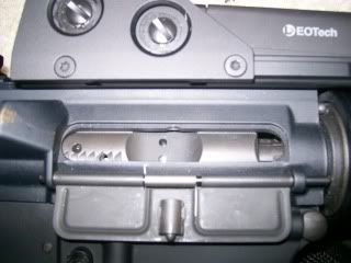

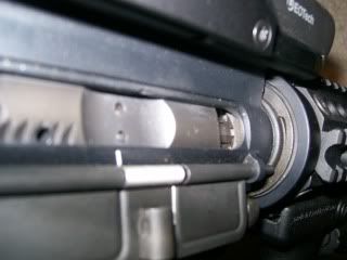

    Got any pics? We like pics of train wrecks!
    C4
  5. #15
    Aug 2008
    Midlands SC
    860
    Thats where the bolt is stuck at, and it won't budge.
