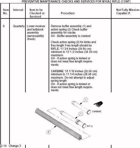

    Are ISMI springs Chrome-silicon (Valve) A877 or Chrome-silicon (Commercial) A401?
    So, 8000 rounds on a typical USGI spring is probably too much. Since this one was probably 9 inches and change, would you probably have changed it out earlier, at say, 10 1/4 inches if that spec had been in your data bank?
    Aubrey posted this elsewhere:
    Don't know which CS they use (never asked). The owner did mention that it was the most expensive CS he could buy.
    I would change CS springs out at around 5K. I would change out cheap SS springs at around 3-4K.
    C4

    Have read that before and is a good data sheet. One of the key points in that sheet, is that some some springs can lose much of their "life" with just 350 compressions! I have seen with some new AR springs and it is shocking to see the spring lose so much of its length so fast.

    How do the lengths of these new springs compare to the standard that Submariner posted?
    All that needs to be done is take the picture with a ruler alongside the springs. Buying a ruler is more cost-effective than arbitrarily picking a round count at which to replace the action spring.
    While few may have been talking about action springs and reliability, the TM cited has been around since the 80's with M4 revisions added in the 90's. RTFM as Rickover used to say.
