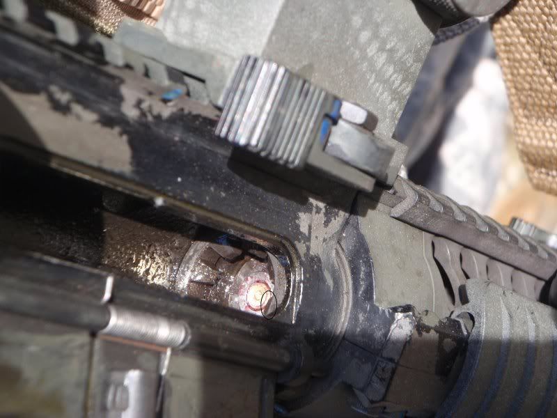

    In this 3-day class, I ended up shooting more than 1,200-rounds, almost 600-rounds of that during the first day alone. Unfortunately, I was using Wolf polymer for that first day and everything went fine until about the 500th round. That's when I experienced my first stuck case during one of the high-round count drills (multiple targets). It was so stuck that a piece of the STEEL case was tirn right off. I pulled myself off the line and rod the case out.
    First Stuck case:
    I went back onto the line and experienced a second one soon after. This one would not come no matter what I did and resulted in me having to switch to my other SBR (LMT MK 18 upper) for the last two magazines worth. I had to soak the stuck case in "Carbob Killer" for more than 4-hours before I could get it to loosen enough to be able to knock it out using a cleaning rod and a hammer.
    Second stuck case (after successful removal):

    I finished the rest of the class using a mixture of brass-cased ammo without a single issue. What is curious was the fact that there were other shooters in the class who also shot Wolf but did not experience the same issues. However, there were others who did experience problems similar to what I experienced to include one who was shooting 5.45x39 ammo (curiously, his barrel would ring/resonate after each last shot). The biggest difference was that those who did not have any problems actually took the time to lean and lube their rifles (at least the chambers) during the short breaks.
    The good news is that the chrome bolt and extractor combination I installed in my rifle worked very well!! So well that it actually ripped a piece right off two steel-cased rims. The bad news is either I have a very tight chamber (doubtful after over 9,000-rounds through it) or I have a rough chamber (quite possible).

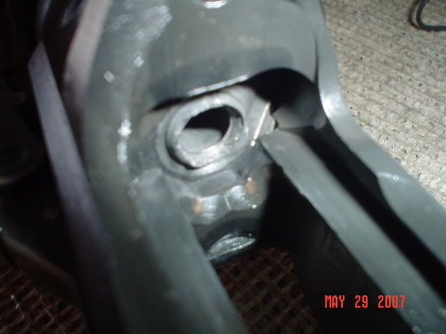

    After I got back, I did a complete and thorough cleaning of the whole rifle. Yesterday I let a couple of people shoot a total of 40-rounds of Polymer Wolf through it. When I got home, I inspected it to determine just dirty this ammo is. Below are the results.
    After 40-rounds of Wolf:

    It's still the primer selant thats the culprit. You can see it migrating into your chamber.

    Quote Originally Posted by Heavy Metal View Post
    Yup. In the last photo, you can also see how much of it is making its way into the ejector channel and under the extractor after just 40-rounds!!

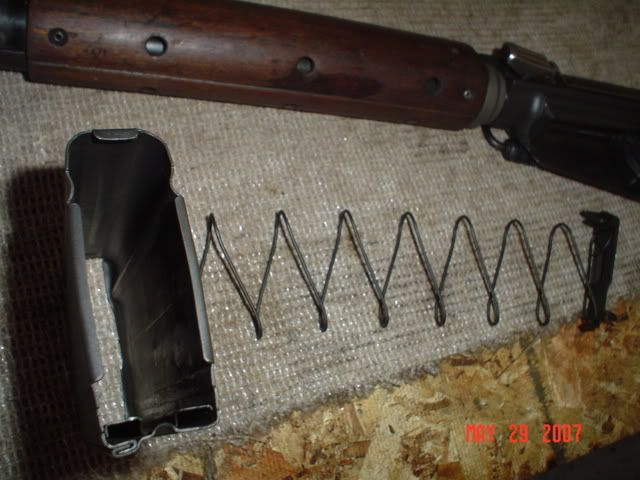

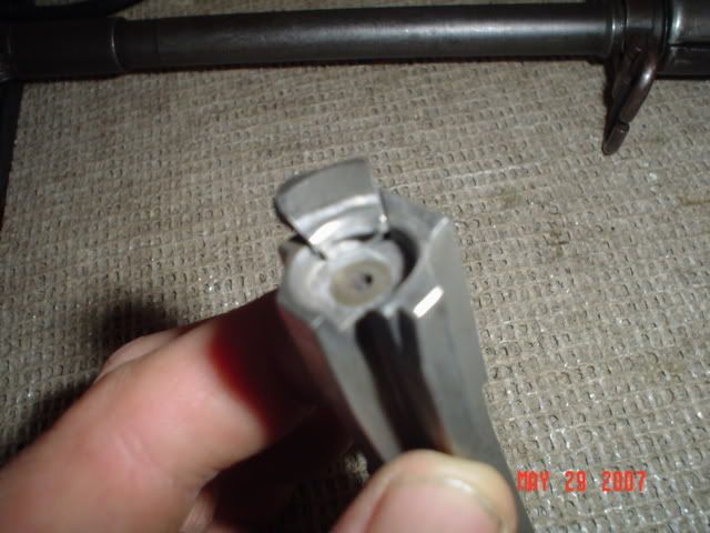

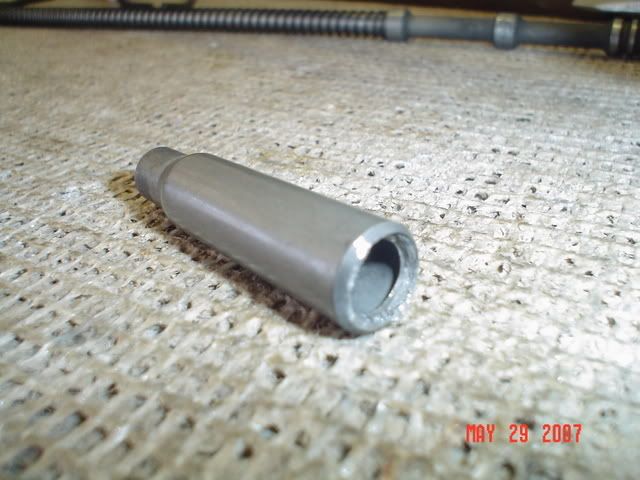

    So last weekend I go a good deal on some Wolf 308. Went out to the desert for some varminting but the weather didnt cooperate enough to blast the FAL alot. I actually only shot 10 rounds of the Wolf and it worked fine except for a couple of the primers popped out of the casings. So yesterday my brother in law and I headed out to the local public range. I had 1 round in a mag so I inserted it and pulled the trigger. We've all seen the pics. The casing stayed in the chamber and the back of the casing blew off. It blew the guts out of the mag swelling the mag body and was quite scary. One heck of a percussion and some bits in my face. Anyways im ok, the rifle is ok, the mag is now a few spare parts (never did find the floor plate). Here's some pics. Gunna go back and trade this stuff in. Perhaps some pics sent to Wolf are in order.
    Pic of the bolt and extractor. Seems to be fine.
