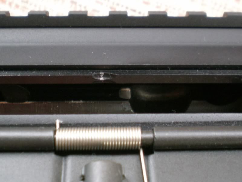

    I bought another Ruger off gunbroker earlier in the week. It's used but the original owner told me the gun had no signs of tilt wear. He says he had about 400 rounds through it.
    I talked to the transferring dealer this afternoon and he told me the gun has arrived. Unfortunately, he closes at 2PM on Saturdays so I'll have to wait until Monday to get it.
    Anyway, I will try to get another 1,100 rounds through it over the next couple of weeks and see how it looks then.

    Gun #2 is here. This is supposed to have somewhere around 400 rounds through it.
    I was hoping to get three or four mags fired this afternoon but it ain't going to happen today.
    Note that we still have a little bit of cam pin drag but there's really no sign of tilt wear to the buffer tube. There are a couple small flecks of finish wear but no gouge marks yet.
