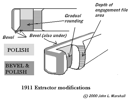

    My guess is that if the extractor is clocking, or rotating in its tunnel, it might play a part in erratic ejection. The EGW fp stop will probably correct that. Here's a pic describing all the surfaces of an extractor.
    You might also send a PM to Wichaka. He's a 1911 armorer and has helped me out a lot on one of the 1911 forums.
    Hth

    Quote Originally Posted by Hersh View Post
    Hth
    Hersh, the more and more I am reading about this the more and more I think you are correct.
    I wish I had the pistol in front of me to better diagnose the problem, but shouldn't an oversized FPS and new extractor fix the problem?

    Quote Originally Posted by decodeddiesel View Post
    Yeah in theory if the fp stop is fitted really well to the extractor it should eliminate any clocking. I'd strongly urge you to contact Wichaka also. I understand the theory behind these modifications, but he's forgotten more about 1911s than I'll ever know and could help you with the finer points.
    He carries a 1911 for his duty weapon and has helped me diagnose several problems. He's GTG and always glad to help!
