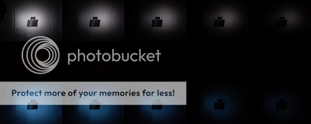

    Each set of photos was taken @ ISO 200, F/1.8, focal length 50mm
    Shutter speeds on each grid from left to right are:
    1/60 -- 1/125 -- 1/250 -- 1/500 -- 1/1000
    Lights from top to bottom in each grid are:
    Stock G2 (SureFire P60 incan assembly)
    Malkoff M60 Low module
    Infrared LED P60 drop-in (don't know the brand)
    The first set of grids were taken with a stock Nikon D90 which obviously captures color images in the visible spectrum. White balance was locked to "daylight" for consistency across exposures. This is a pretty standard WB setting to use amongst flashlight nerds. It tends to make incans look a bit warmer than the naked eye sees them, and LEDs a bit cooler. In any regard, the eye is much more adaptive than a camera: your brain is very good about knowing colors under mixed lighting. A camera is much 'dumber'
    Note that the stock D90 didn't pick up the IR flashlight at all. While the Malkoff and the P60 don't look worlds apart in brightness, there is a difference. It becomes slightly more apparent when the image is desaturated so you aren't focusing on the color differences as much:

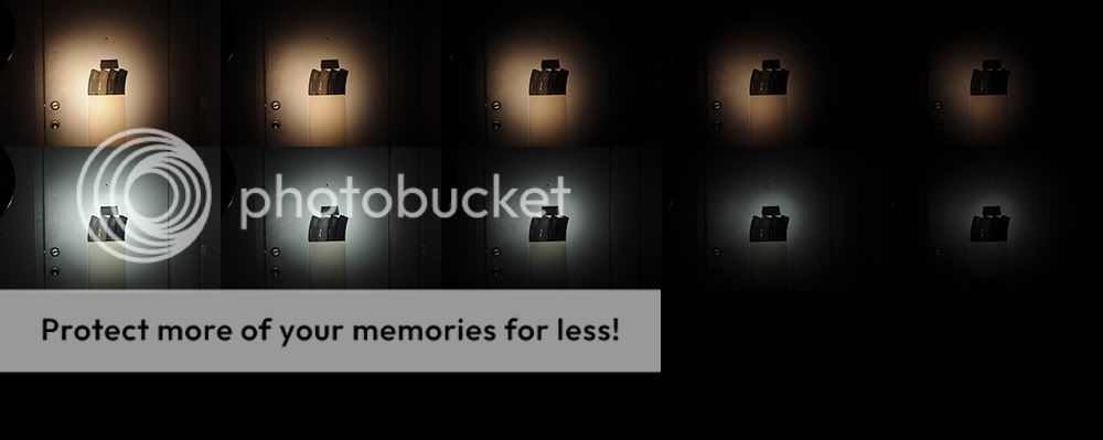

    The second set of grids were taken with a D50 which has been converted to capture infrared images. Its internal filter was replaced with a custom one so that only infrared light passes to the camera's sensor.
    Note that now the Malkoff has pretty much become invisible. There is a slight hint of light at the slowest shutter speed but you can barely see it at all, and the IR filter in this camera isn't even that "aggressive": it's right at the border of the invisible/visible spectrum.
    Same IR photo desaturated:
    Note that the incan still looks almost as bright to the IR camera as it did to the standard camera. As far as I am concerned, that is wasted energy. My eye can't see it, so why do I care about it?
    The bottom row is the IR flashlight, which is invisible to the naked eye. If you stare directly into it (don't), you will see a faint red, but that is it. I am sure you are wondering why it shows blue in the image. The infrared camera has to use a custom white balance setting. Bright IR sources blow out to blue in it. There's no "real" white-balance setting for infrared since you're asking the camera to turn invisible colors into visible ones.
    You may be thinking, "Well, Byron, the Malkoff doesn't look THAT much brighter." Yes, the difference isn't mind-blowing, but there are a couple things to note:
    - This is the "low" power Malkoff - there are much brighter Cree modules out there. If anyone really wants, I can dig through my pile to try to find something more scorching.
    - The P60 incan was never used before these tests and had a fresh pair of batteries. Take a look at the runtime graph on this site for the G2 and note that the p60 is down to 75% brightness within 5 minutes of burn time on the batteries. It holds there for a little bit, then declines steadily. This is pretty standard for incans. On the other hand, modern LEDs are well regulated, with a much flatter discharge curve.
    This means that "what you see is what you get" in terms of LED brightness. If I had run that G2 for a couple of minutes and then done this test, the difference would be much more dramatic.
    - Even if you believe that the difference in brightness is no big deal, the run-time on the SureFire is rated at 1 hour, while the Malkoff is 4.5
    If you guys want any other clarifying images, please let me know, but I hope this is at least slightly helpful. There's always a brightness/runtime trade-off. I chose this Malkoff unit because it offers me very good brightness, an amazing runtime, and can safely be used for extended periods in an all-plastic light.

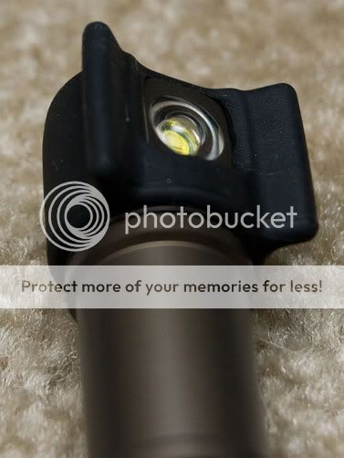

    Here's what I was talking about in terms of fun form factors that were previously unattainable before Cree (at least with this much performance). This is a review for a headlamp that I wrote on another site back in the end of 2007 when I had owned the light a few months. It may be slightly dated (references to cost may have changed) but I am more trying to show why I think the Cree revolution has been so exciting.
    I originally got this Zebra light as a 'niche' light that I thought I would only occasionally use. Since the first one though, I have purchased a couple more because I use them constantly. Having even-spread hands free light is great when I'm working on something, reading, or doing similar activities. I love these little guys and have been running them for almost two years now (as long as they've been on the market)
    Anyway, I am sharing this more as a peek at form factor possibilities than the light itself: hopefully you find it somewhat interesting.

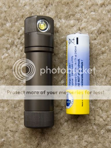

    The Zebralight H50 is a hands-free light, primarily designed to be a headlamp. It runs off of a single AA battery of any type (Alkaline, NiMH, Lithium, Li-ion) although functionality is somewhat limited when using Li-ion (brightness modes are altered, as detailed on official site). Reverse polarity protection is included, and the circuitry also prevents over-discharge of NiMH's. The H50 utilizes a Cree LED emitter in either P4 or Q5 bin, and offers the user three brightness settings. It is a tiny light that is practically weightless and serves as a great tasklight given its beam profile of pure flood.
    H50 as compared in size to a standard AA NiMH.
    Zebralight is a new company, the H50 being its first offering to the market. This light was designed with some input from the CPF community and has been very well received. The two things that immediately separate it from the majority of headlamps on the market are its Cree emitter, offering amazing runtimes on a single AA, and its unfocused beam. The emitter in the H50 sits behind a small Lexan lens which smoothes out some of the artifacts inherent in the raw beam profile and protects the emitter, but still allows the light to spill out at an amazing spread of 120 degrees. Some users have complained that this is actually too much flood, but I find it to be fantastic for any close range tasks, whether I am reading, working with my hands, or navigating at a walking pace. The flood does have a shorter range, of course, and so some users who anticipated using it as a trail running light were disappointed in the inability to see obstacles at further distances.

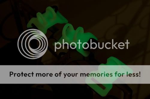

    The GITD brackets take a glow very easily and retain it for a long time, easily out-doing consumer glow products like those stick-on-the-wall stars, for example. The silicone brackets and pocket clip are soft, but feel durable. I have owned the H50 for almost two months and have so far seen no reason to worry about their durability. I get most use out of the clip which can be slid on the light in an emitter-up or emitter-down configuration, and allows the light to rotate.

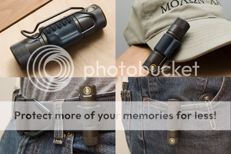

    Various methods of clip carry.

    GITD brackets.
