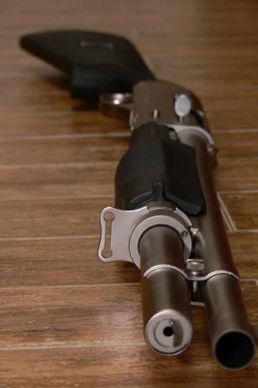

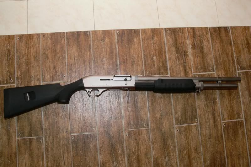

    [IMG][/IMG]
    here's a pix of it. no extension. it's a 1pc. or am I wrong?
    [IMG][/IMG]

    Remove the barrel/mag clamp
    see that knurled round object forward of the sling mount ahead of the Handguards, that it, unscrew it but keep pressure on it as you do so it doesnt go flying when it comes undone
    ETA it also appears to have the mag limiter installed, you can remove that once you get the tube off and have full capacity

    That's not a 1-piece tube. It also looks like you have a set screw holding the extension in place. You'll probably have to back it out a bit before you can unscrew the extension.

    Quote Originally Posted by DRich View Post
    +1 good call!
    Take the screw out then follow my instructions above
