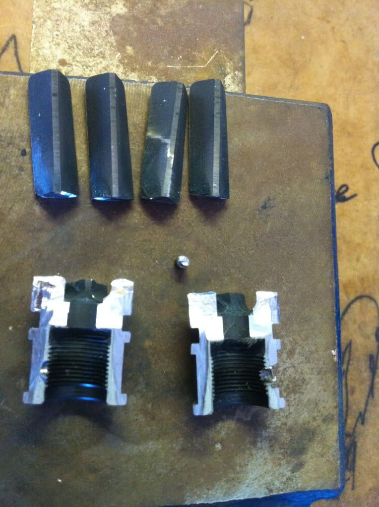

    Are you a Jedi Master with a Dremel??
    Look how close I came to Pappabear's Noveske threads.
    The tines were cut off to get them out of the way.

    The problem with that hope is that once you start, you're kinda commited to the project.
    I tried that crap on a PWS perm and it didn't work. Wasted a bunch of time too. Best to just cut the unit on both sides and break it in two with a big screw driver.

    Just know where your threads are. Going slow and not wrecking a barrel is worth the effort. I took a long time on my first one.
    PWS was a piece of cake because I could see the barrel threads. That stupid vortex was nerve racking because the muzzle end covers the barrel diameter and threads.

    I've always sawed off enough of the muzzle device to get a center into the muzzle then turned the outside of the device on a lathe until the pin was exposed. Obviously, not the approach to use if you want to save the device.
