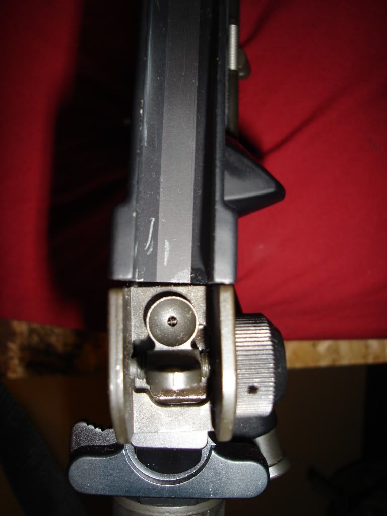

    I saw the picture below in another thread and wanted to ask a specific question concerning the issue depicted in the picture. I handled a number of used, Colt, removable carry handles at my local dealer and each and every one had the rear sight move in the fashion noted in the picture. My dealer was very honest about the fact that every one he had did the same thing. He indicated he was told this is common to the removable carry handles. I've always used a folding BUIS, so I have no other experience with these. My question then, is this truely a common characteristic of the removable carry handle?

    yep it's normal.
    take a look at the pic below... the sight is canted due to spring #4

    Yup, all 111 of the M16A2's in my vault (I'm the fulltime supply sergeant for my Guard unit) have the same apparent twist. And most removable carry handles use standard A2 sight components. every time we qualify, someone tries to use this as an excuse for their horrible shooting!

    This is not all purely an alibi. That is why the National Match Service Rifles, if properly set up, will have part # 9 pinned to part #24).
    There will be a guide pin on the front and rear of that part (#9) so that the adjustments will not cant the rear sight in relation to the rest of the A2 upper or the removable carry handle in the case of a NM AR 15 A4.

    True, but dosn't the NM sight have a smaller aperture, as well? I'm willing to bet that the size difference mkes for a bigger accuracy differential than the canted aperture.

    Actually, I believe the canted aperture is a bigger problem. The human eye will naturally center the front sight but canting is another mechanical aiming issue altogether. For example when David Tubb cants his sights at an angle - it is to make corrections for his body's natural positioning. But his sighting system as a whole is canted, not just the rear sight! He is canting his rifle in the opposite from the way his body is canting - esp. in the standing position.

    I don't know for sure but that particular carry handle sight looks far more canted than what I remember. Im holding a USGI carry handle sight, there is some wiggle. But there is not the gap shown in the picture.
    I had another follow up question regarding something mentioned earlier. If the rear sight is pinned to the carry handle, how can you elevate the sight ? Just curious, excuse my ignorance.
