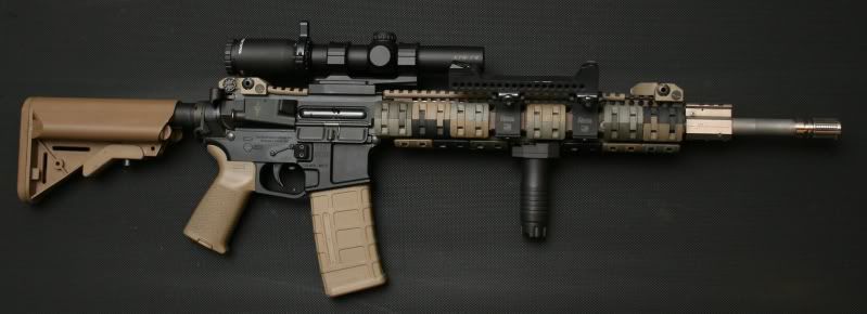

    My 3gun rifle as current as of today 7/20/2009, it's a work in progress.
    18" WOA SPR 1-7 twist .223 Wylde chamber barrel turned down to .650" under the rail (courtesy of W.A.R. Rifles). JP adjustable gas block LMOS carrier and close range sight, BCM bolt, KAC Triple Tap comp, VLTOR MUR upper, DD RIS II M4A1 rail, Bobro forward grip and 30mm scope mount, Burris XTR 1-4x 30mm scope, Charles Drissel 'cat-tail', Troy FDE flip up sights, PRI gas buster charging handle, Tactical Innovations lower, Geissele trigger, LMT SOPMOD stock in FDE, Magpul XTM covers, MOE grip and MS2 sling and PMAGs, Arrendondo mag button. Assembled by me 'gotm4'.

    Just like mine.... I wish.
    My 18inch LMOS upper is on its way, what weight buffer do you run? The real LMOS buffer is rifle length so it won't run in a carbine reciever extension like in your set up. (I'm going to run an UBR).

    I'm using a CAR buffer (the lightest one I have, 2.9oz). A normal CAR buffer and JP LMOS rifle buffer both weigh 3.0oz. I was using a 1.8oz that I took some weights out and replaced with Delrin but it proved to be not quite reliable enough. I use a standard rate chrome silicon spring from Brownells. The UBR uses carbine length buffers and springs so you'll be able to use a CAR weight buffer. Eventually I may use a UBR stock in FDE on this gun.
