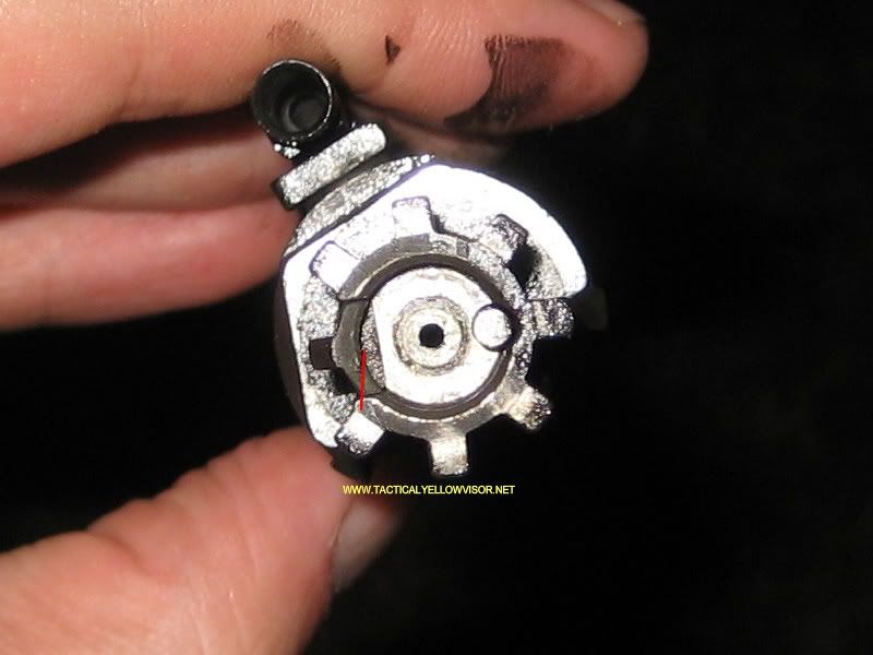

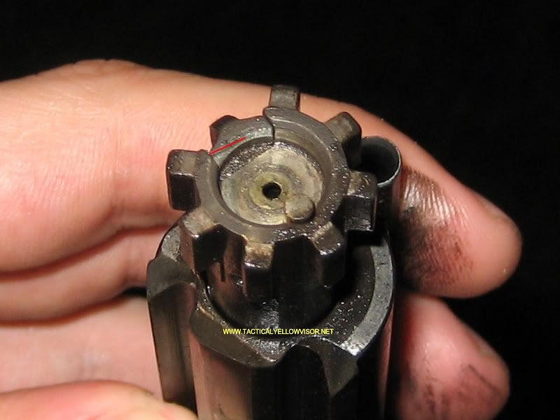

    pics, which are not so great. Tried to show the pics unretouched and with a red line indicating the shear point. Pics of second extractor didn't come out so good and don't really show anything. I'll try to swap Jack a new BCM for his sheared one.
