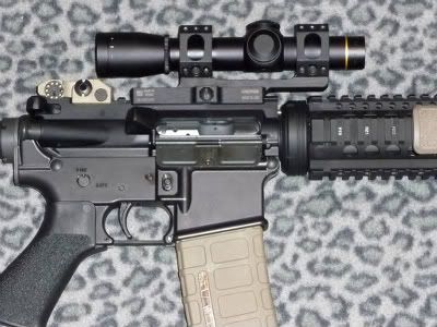

    ADM mount that I used on this rifle (cost $155)

    Ski Devil,
    How long is the mounting rail that you have in the pic above, 4"? The RRA mount is 5+ inches but I really bought it for my varmint setup that does not have BUIS. If I put a scope on my carbine then I think I will go with the LaRue because it is like 4 inches.

    The mount in the picture is the ADM Recon mount 1" diamter model. The base of the one-piece mount which attaches to the flat top rail is 3 7/8" in length. The entire flat top of my M4 CMT upper receiver from front-end to the charging handle is approx. 7" in length.
    Before you buy one, try to look at both and decide which suits your needs better. They are both excellent products. One observation which I have made, and is reviewed at the websites of both companies is that one requires a tool to set-up/ adjust (initially) and one does not (ADM). Also, typically the ADM mounts are less expensive, but not substantially. I would say go by personal preference. Many on this forum prefer the La Rue. I used to but now the ADM is growing on me.
    Either way you are safe. Both good products with excellent customer service.
