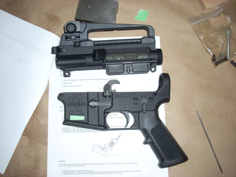

    I started with a stripped Mega Upper and Lower. I didn't intend to start out with a stripped Upper, but it just worked out that way. Anyway, I've now added a GI FA bolt group, and an ejection port cover, along with a carry handle that will have to suffice until I decide what I like better for sights.
    On the lower, I added a Doublestar LPK, and used the instructions from a manual downloaded from ar15.com. Everything went well, with no loss of any finish anywhere. I made a tool for the magazine catch that can be seen in the upper right of the photo (a block of oak with all of its edges sanded off and a dowel for depressing the magazine release button. I also made a pin installation tool out of a 1/4 inch bolt that worked perfectly. Well, almost perfectly, the first time I pulled my punch out I launched the detent into oblivion (happily, Doublestar includes an extra).
    I had one hick-up that still concerns me; the function check for the disconnector failed until I installed the selector. After that it works perfectly, so I don't think I have a problem. Anyone thinking otherwise, don't be shy. I shoot at a State gun range and they will not take kindly to any unplanned thermal events.
    The tools I used were mostly transfer punches (one can be seen in the pic, lower right although this one was only used for alignment and not to drive anything) and a small ball peen hammer. I taped all surfaces adjacent to where a tool might slip (although none did). I was very happy to find that the bolt catch roll pin was tapered on both ends, which made starting it a snap.
    Overall, I pretty happy with the LPK. The trigger is no creepier than my other AR (a stock service rifle), and breaks crisp and smooth, once the slack gets taken up.

    Question What brand upper Reciever?
    Wallyg8r, what brand upper Reciever do you have in your Photo?
    Aug 2009
    58
    Mega
    It's a Mega Machines, just like the lower. Why?

    Thanks! I just finished installing the barrel, but not too sure about the A2 compensator:
    1) Holes up or down? I would guess down to keep the flash out of my vision, but up would counteract muzzle rise. Which is it?
    2) what is the torque?
    Roy
    10 year vet; United States Air Force
    Isaiah 40:31, Mark 16:16, Luke 22:36
    Aug 2009
    Gainesville, FL
    21
    Holes go up on an A2. Torque specs are anywhere between 15-20 ft lbs. Mine are all torqued to right at 20 ft lbs.
