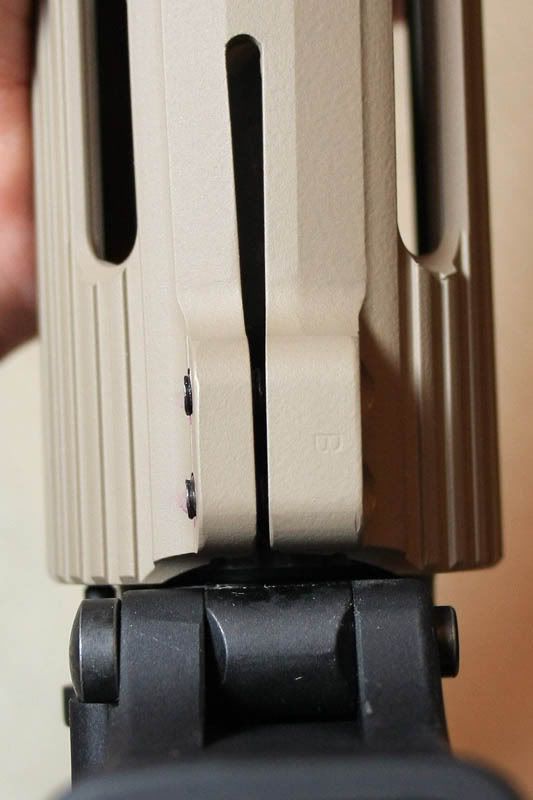

    The rail slides onto the nut at about 2 o'clock you then rock it left back to noon and then tighten the two allen head bolts. It is pretty solid.

    It does squeeze down, but on a proprietary nut. You give it a little twist at the end and it kind of locks down and then you tighten the 2 bolts. it's very secure. You can flex it some but I don't think the attachment point is giving. I think the whole unit just has some flex in it.

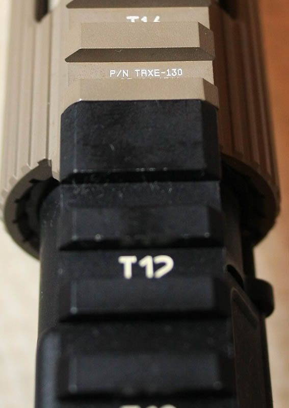

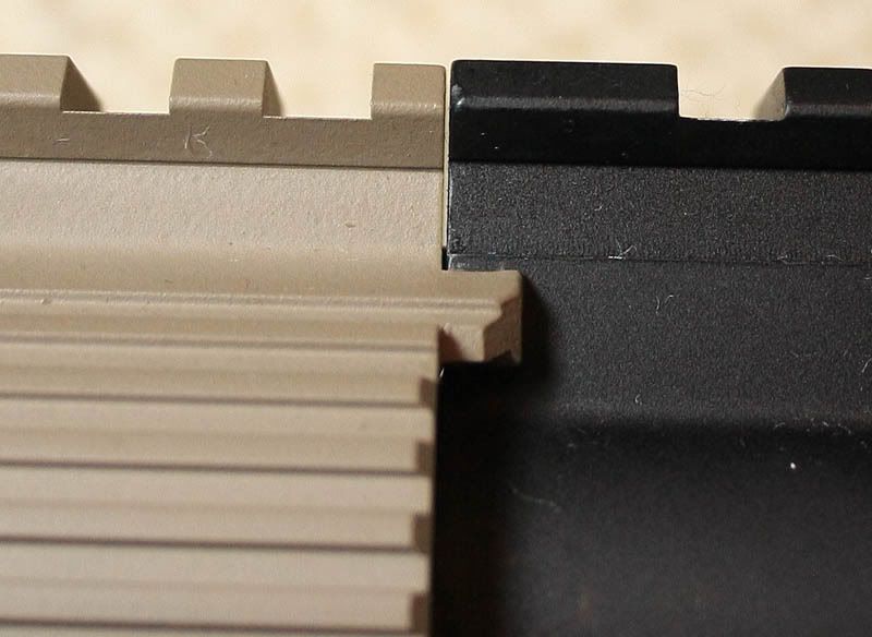

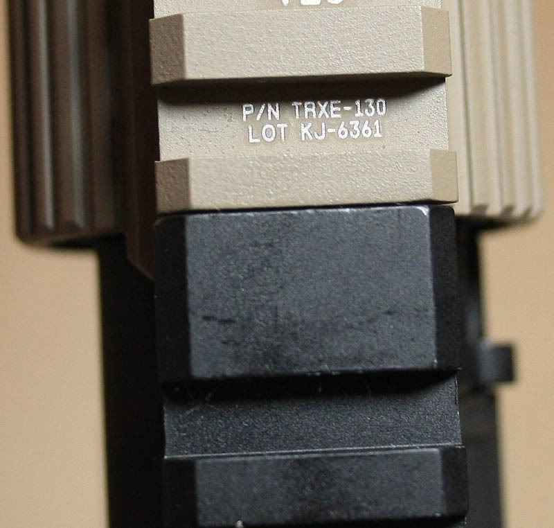

    Alignment issue?
    Hey all. I just installed a 13 inch Vtac on my rifle today, and I think I'm having an alignment issue. The top rail on the handguard doesn't line up with the top rail on the receiver. Eyeballing it, I'd say it's maybe 1/16 of an inch further right. It's also lower than the receiver rail by the same amount. Is this within acceptable tolerances (if such a thing exists), or is it more likely that I installed the rail incorrectly? I don't want to loctite the allens without knowing if this is a problem. I'll post pics if anyone thinks it would help.
    Post a pic if you can. The fact that it is lower than your receiver kinda makes me think that your receiver is out of spec. What receiver did you use? Also, make sure that you lined up your barrel nut properly...

    The upper receiver is a Colt that I got from Brownells (M4 stamped above gas tube hole, C and keyhole on right side).
    I had to get on my laptop to upload those, so I took the opportunity to do a bit of googling. I came up with this thread:
    https://www.m4carbine.net/showthread.php?p=619237
    The problem sounds similar to mine. I can't rule it out, but I don't think my upper is out of spec. Could it be that I overtightened the hex screws on the bottom? I have the instructions here, and they say "tighten 1/2 turn past hand tight... there should be about a 1/8" gap in the clamp." The "1/2 turn past hand tight" thing is pretty vague, but that's what I tried for. The gap is much narrower than 1/8", though. Also, I installed the barrel nut at 45 foot pounds. I started out trying for 60, but there was no way I was going to get the groove lined up to allow me to insert the gas tube. The instructions call for 30-60 foot pounds, so I thought 45 would be a safe bet, and that seemed to get the nut tightened up and aligned with the gas tube hole. It may be worth noting that my rail came with the Troy barrel nut wrench, so I didn't have to jury rig one.

    I have a similar issue on a standard Troy 13.0 after initial installation but for my purposes it really doesn't matter and I haven't taken the time to try to sort it out. I have three other Troy/VTAC tubes and none of them have this issue.
