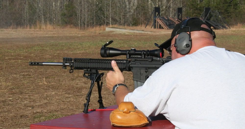

    For that application it'll really be overkill, but if you like the look go for it. The Noveske barrels as well as any barrel can be sprayed with GunKote or Norrels in black.
    If you true up the front end of a CMT receiver with a lapping tool and some other tricks you can get some extreme accuracy of of a mil-spec CMT receiver and if you're using a scope mount like an Armalite or Larue it'll help you even more.
    This upper (which I didn't lap, nor do any other tricks on) shoots .220" groups at 100yds with reloaded BH 60gr V-MAX. It's just a standard 'Wilson' stainless barrel in 1x9 twist with a .223 Rem chamber. I can't remember if it's a Bushy or RRA upper receiver.
