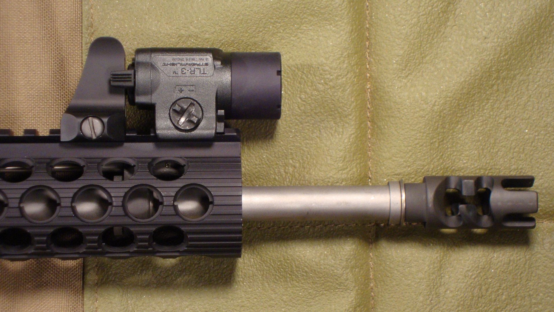

    Robb, have you thought about possibly replacing the X300 with a Streamlight TLR-3?
    I have been using one on an M&P9C for a while now and have been impressed with it's small size and light output. Durability seems on par with the TLR-1 and such, but it only weighs 2.32 ounces.
    http://www.streamlight.com/news_let/09_q2/tlr3.html
    I did install a TLR-3 just last week. It's is a little lighter and a little taller than the X300. So you do see a tiny bit more of the light when using the iron sights. Not a big deal on this gun since it's primary sight is the Aimpoint.
