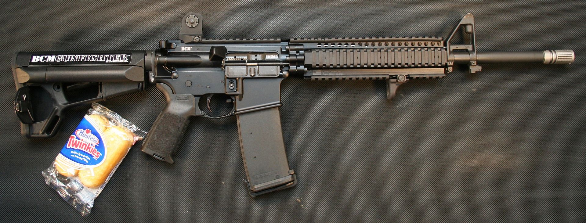

    My Limited division rifle:
    BCM lower w/Magpul BAD lever and Geissele non adjustable trigger. Magpul MOE grip and ACS stock. BCM 16" midlength upper with 9" Daniel Defense Lite Rail and Daniel Defense fixed rear sight and a KAC Triple Tap comp and handstop. BCM Gunfighter charging handle. Magpul EMAG.

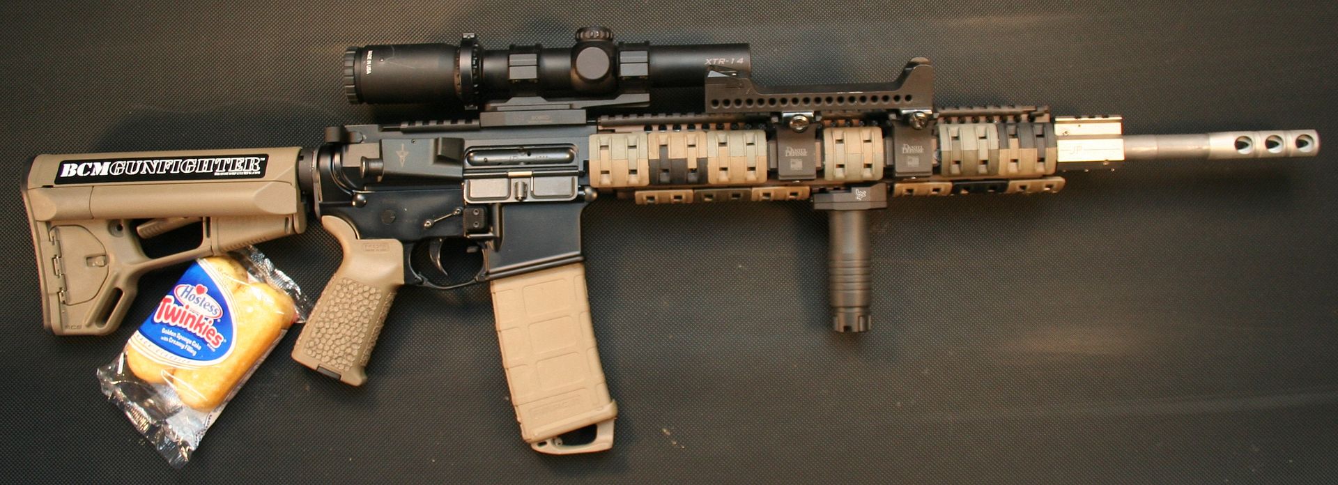

    My Tactical division rifle:
    BCM lower w/Magpul BAD lever and Geissele adjustable trigger, Magpul MOE grip and ACS stock, VLTOR upper receiver, WOA 18" stainless rifle gas barrel, JP adjustable gas block and LMOS bolt carrier with BCM bolt. Daniel Defense 12" RIS II rail with Daniel Defense offsets and a JP close range irons, SJC Titan comp. Bobro scope mount and forward grip. Burris XTR 1-4x illuminated scope. Magpul PMAG with Ranger base.

    Sweet rifles!
    Is the comp on the Tac rifle legal in all the different disciplines? Is that MOE grip OEM, or has it been stippled?
    Is that a KAC finger stop on the Limited rifle?

    Yes the SJC Titan is legal for Limited, Tactical and Open per USPSA rules...1"wide by 3" long (in Open you can go bigger). In the latest issue of Front Sight magazine (from USPSA) there is an article about testing different brakes/comp. The SJC Titan reduced rearward recoil 75%. The MOE grips were texurized by Hatfields Gunsmithing. Rough on the tan one and mild on the black one. Yes that's a KAC hand stop.

    The Titan is something fierce to be around, but as the shooter it is most excellent!
