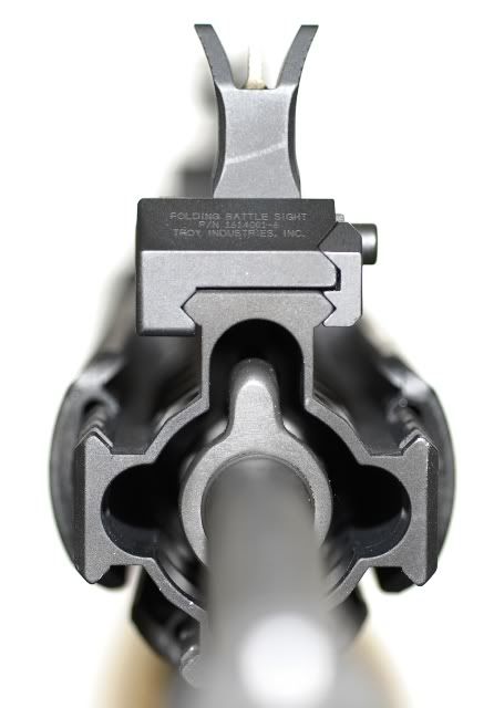

    I simply cut my front sight. Besides that, cant help much. Is it visible?
