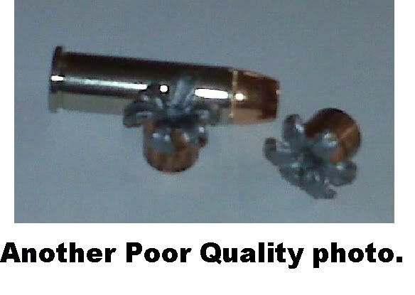

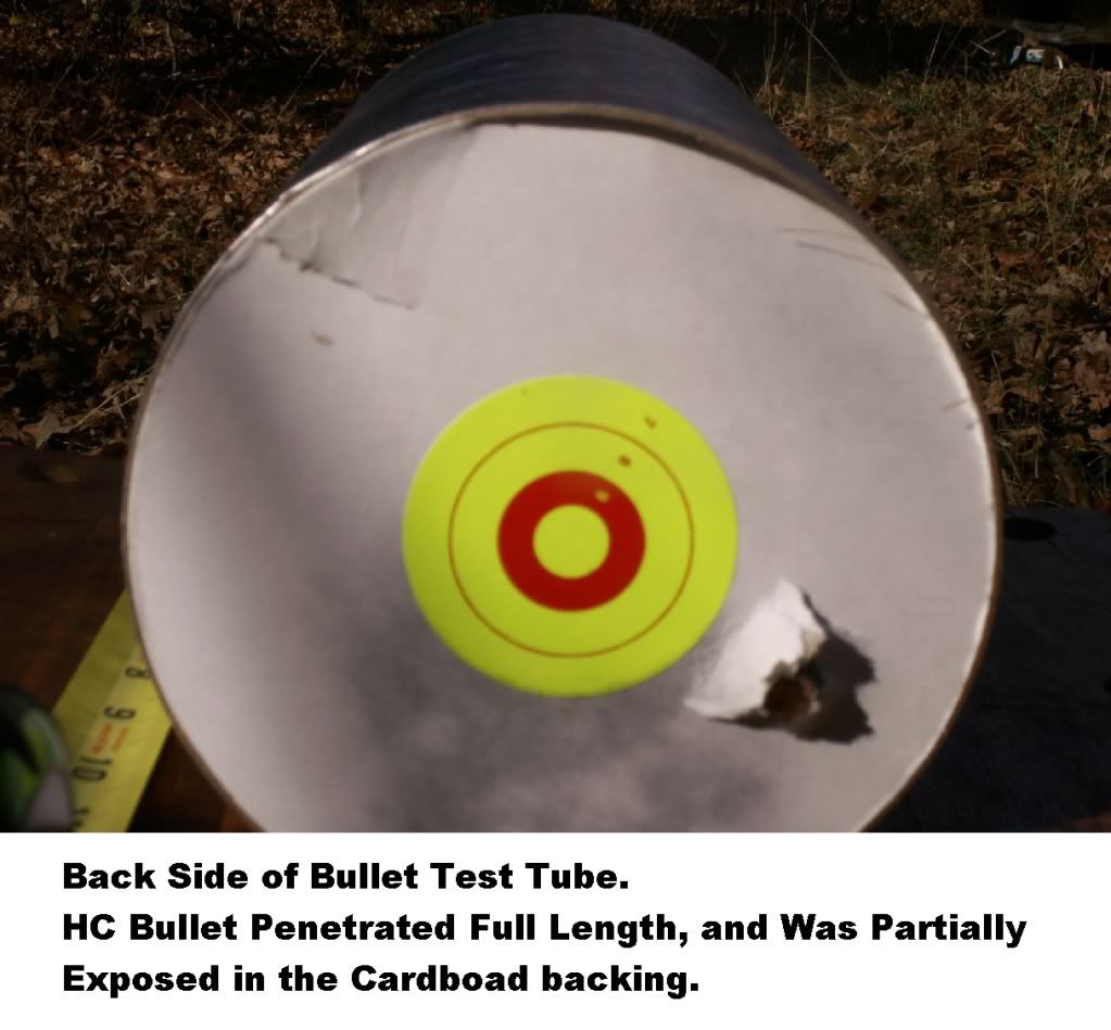

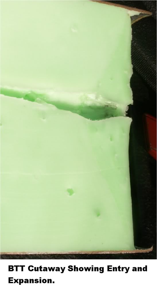

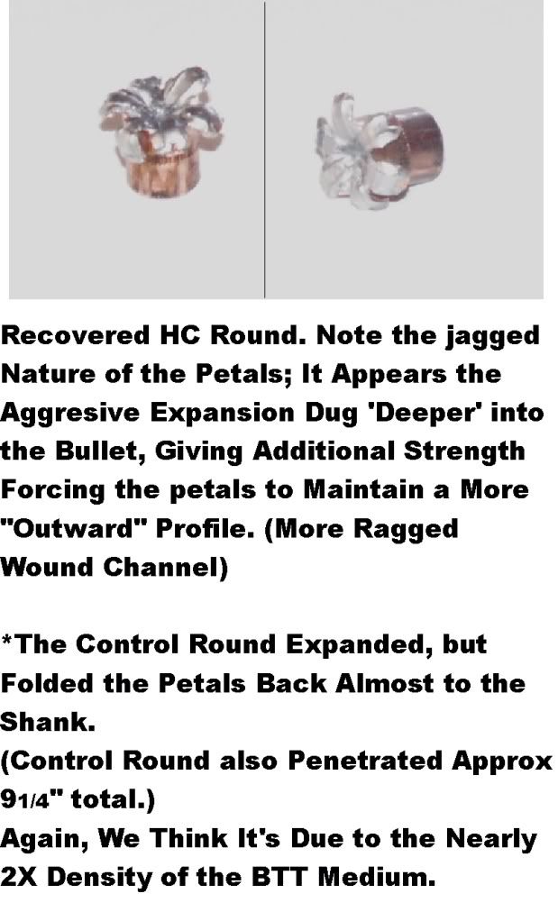

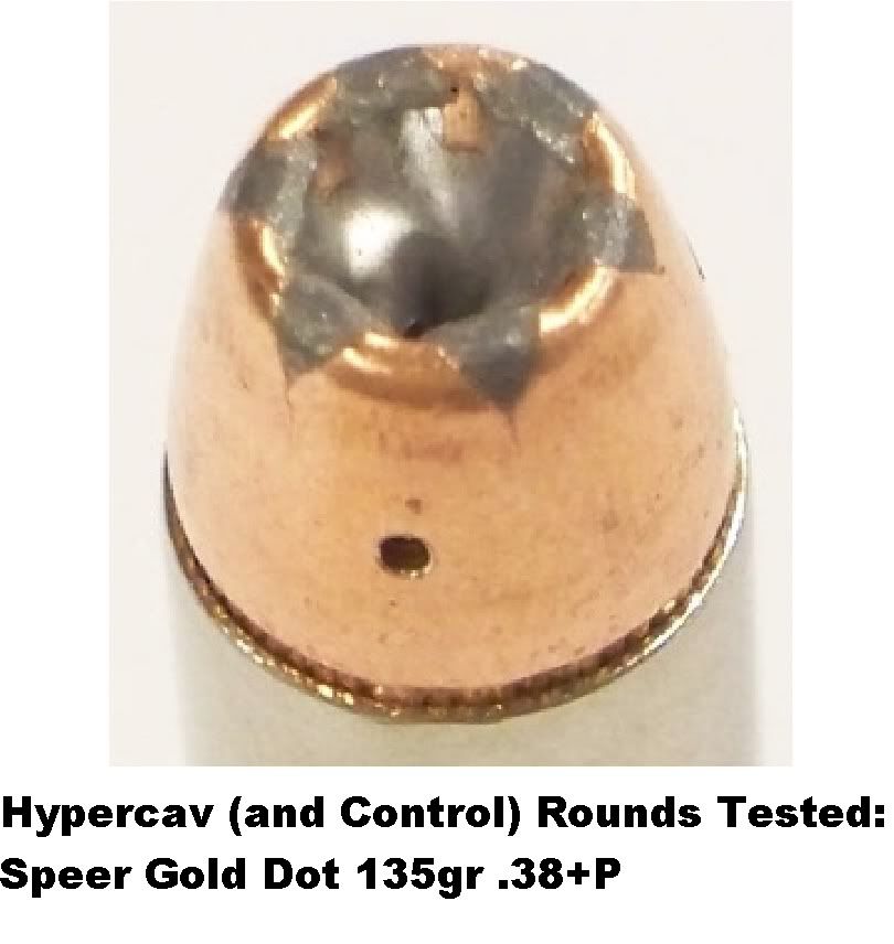

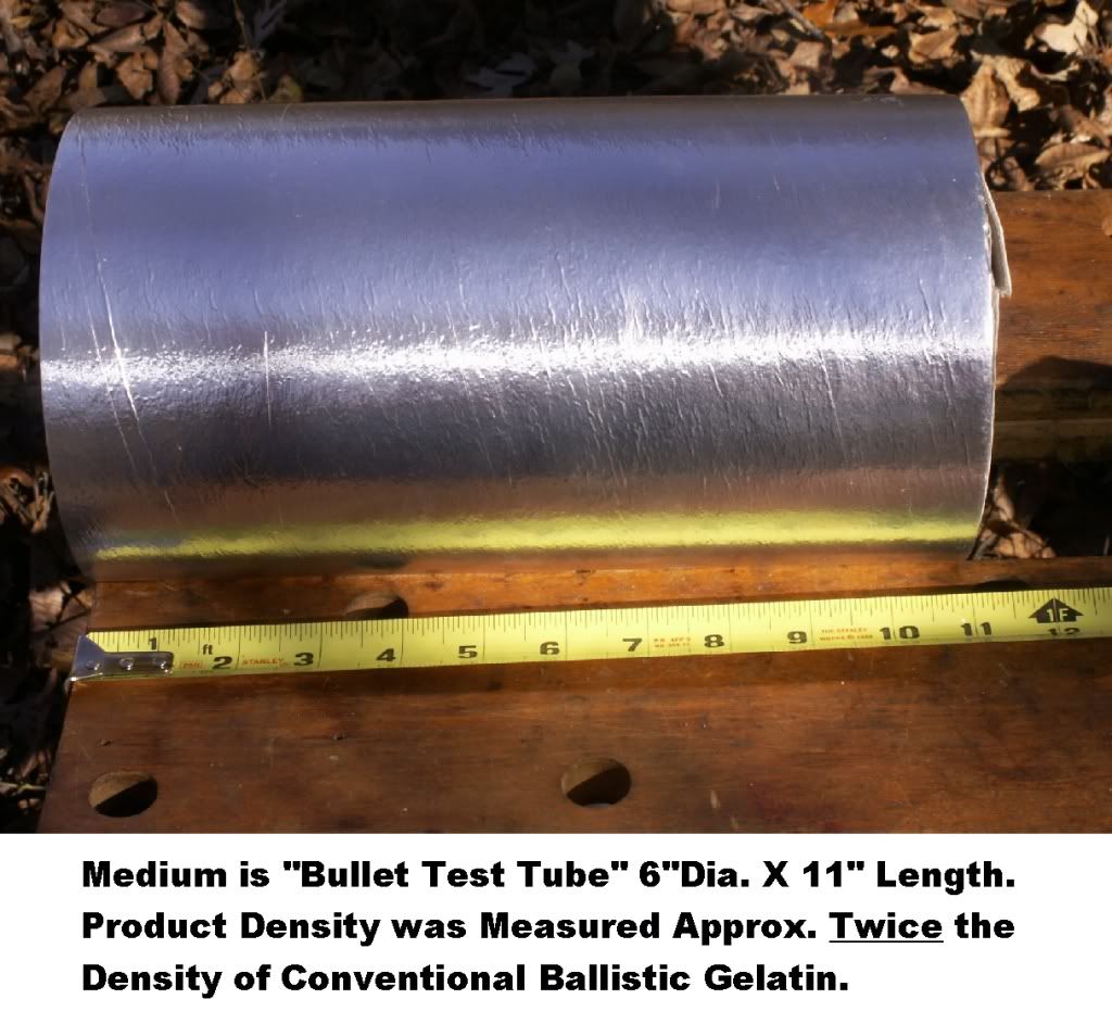

    Ok folks, here's the deal; I've had these photos for some time now, test performed early on in the project's development.
    I've not shared them to date for several reasons. The primary reason is I didn't think this was a valid test, considering the test medium proved to exceed the 'standards' of ballistic gel criteria. We used a medium from "Bullet Test Tube". The idea being it was reusable. (Thinking economy here)
    Turns out though, that after measuring later, the BTT medium is almost TWICE the density of standadrized ballistic gel.
    So, after learning this, we canceled any further tests as this seemed to be a "bad idea".
    I tried to contact BTT, but no response to email, and their phone appears to be disconnected. (I think I know why)
    The next reason, is the quality of the photos are severely lacking.
    All things being equal, my goal has been to present clean, independent scientifically-based test result information with solid data, and quality photos.
    While we're working on that as you read this, please keep in mind the unscientific nature of the pics here:
    **NOTE: You'll notice the three port blast marks as the bullet enters the target.

    11 (100%)
    I missed the picture of the path left by the OEM GDHP. All that is coming up for me is the wound left by the modified one.
