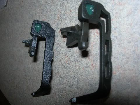

    I had issues with the first EBRv2 I recieved not holding the bolt back after the last round. I contacted Ken at Phase 5 and he was very easy to work with. He sent me out one of the first lightened versions which to date has been 100%. If you are unhappy with the performance, contact him, he is very concerned about selling a quality product and wants happy customers, great guy to deal with.
    Newest version in the foreground.

    Just to be fair when comparing weights between the Phase 5 lever and the BAD, you'll need to include the weight of the bolt catch with the BAD since it is one piece with the EBRv2. Using the weights in this thread that puts the BAD at 5/8 oz. and the EBRv2 at 3/4 oz. 1/8 oz. is alot closer in weight than the numbers posted seperatly would lead folks to believe.
