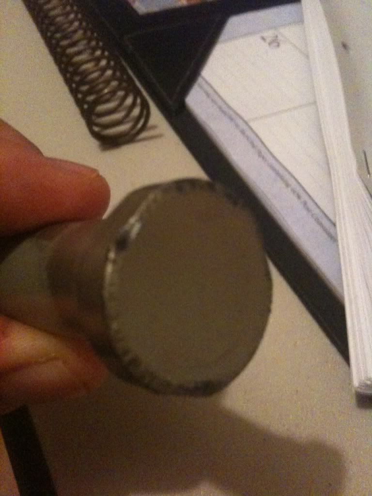

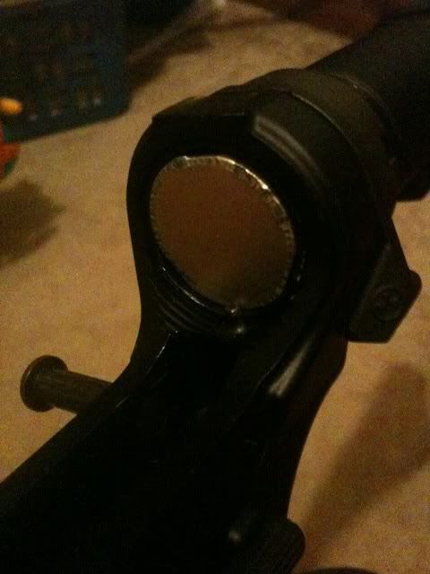

    Different Marks on Buffer????
    Ive been shooting my AR build and noticed weird marks around the edge of the buffer face. It looks like the pin is hitting the buffer. I took it to a local Gun Smith with a good rep for black rifles, he said the lower is probably out of spec. That would not surprise me... its a ROGGIO ARSENAL. I already ordered a better lower and a DD LPK to go in it. Is it possible I put the lower together wrong. Also any tips on the latest buffer to run on a 14.5 Middy would be appreciated.

    Several Roggio Arsenal receivers were pretty far out of spec. They were pretty good about replacing them. I'd suggest calling/contacting them. The buffer detent hole on yours is milled too far back.

    Is the rear of your bolt carrier flush with, or slightly above, the back of the upper receiver?
