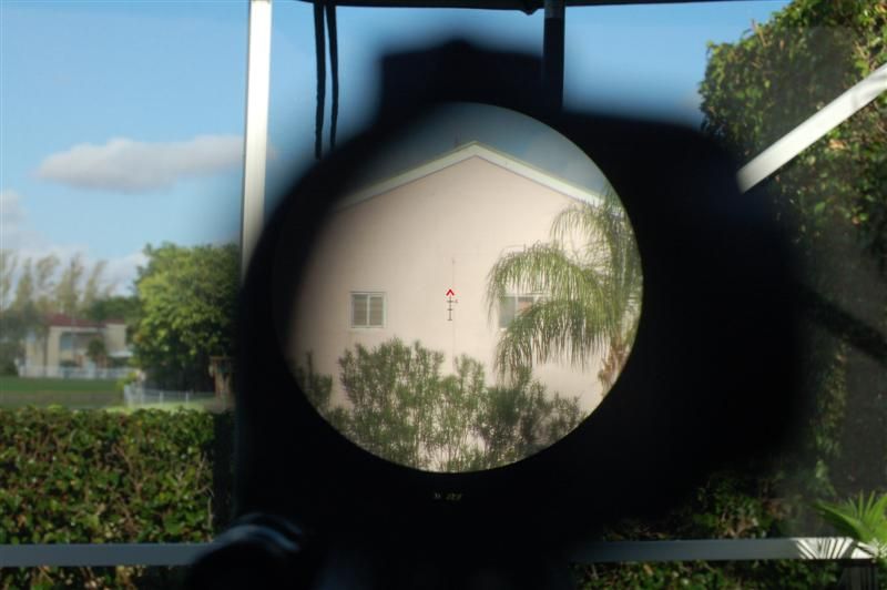

    I have used the TA33 as a standalone optic extensively in matches and classes pretty much since it first came out. Our matches are from 18:00-22:00 on an outdoor range under sodium-vapor-type stadium lights approximately 75 yards from where we shoot. In that environment I never had any issue acquiring the reticule or with brightness of same.
    Additionally, I have never had any problem finding the hash marks on the rang-finding portion of the reticule when viewing them through the tube on a distant target. For example, I can stand in my living room and look at the wall through the optic and not even see the stadia lines, but if I look out the sliding glass door at the house across the pond they show up clear as day.
    Where I found the TA33 lacking was indoors and in very bright sunlight. When doing dryfire indoors and running some home-defense scenarios the reticule turns black and is almost entirely invisible. When zeroing outdoors on a cloudless day I actually had to tape over the fiber optic tube to get the reticule dim enough to precisely aim with the tip of the chevron.
    IMHO, the TA33 alone is a great gaming optic. A little slower up close for sure, and moreso without sustainment training, but lightweight and compact which I like.
    If I were going to run a T-1 in conjunction with something else I think it would be with a variable-power magnified optic that started at 3x and went up to something else.
    View through the TA33 of the house across the pond.
