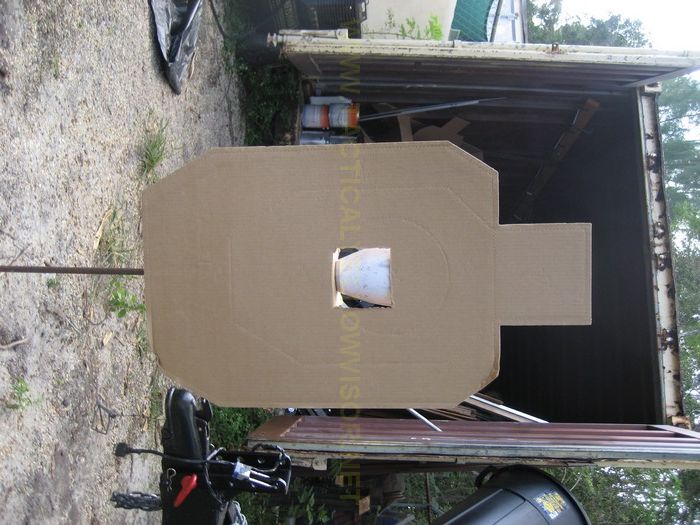

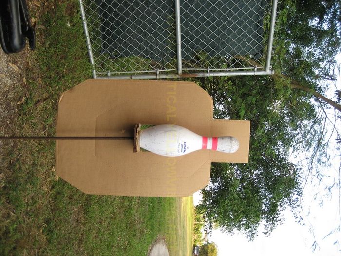

    This is a takeoff of an idea that a local area cop and training officer shared with me, that we played around with the other night. We ran into a few issues but first I'll post the pictures and video.
    SE FL
    14,148
    Some issues we encountered...
    1) Even with the pin clearly visible, some people still shot low and hit the goddamn stand. One hit the post under it, rendering it useless going forward although allowing us to continue to use the stand for the rest of the test, and one hit the shelf the pin was sitting on.
    2) Obviously it only takes one "hit" on the pin to drop the target. Perhaps not as realistic as we might like.
    3) The pin becomes a wear item, and how fast it wears out with the carbine rounds is much greater than with pistol rounds (we only shot it with carbines, 5.56, 7.62x39, and .22 and even the .22 was able to drop it albeit with multiple rapid hits)
    4) In the S Florida humidity targets can and will bend and warp. While damage from the target hitting the deck is a non-issue, short sticks (throw-aways from the sticks that get shot off?) may be needed as stiffeners.
    I am going to work this in to some of our matches, hopefully with multiple targets shot this way, on the move, at a greater distance, to see what's what.

    how about raising the stand behind the target and hanging the pin from a rope/string? it's still "reactive" but it would take alot more shooter error to kill it.

    it should be stated that the goal here is to have a man-sized target that reacts appropriately in that it falls down.

    Neat idea. Careful with those pins - pistol rounds can and will bounce back off of them.

    Ahhh, that changes my response a bit then.
    The reactive targets I've shot in the past were about hitting a certain area and continuing to fire until it was hit without seeing it (threat neutralized). Being able to see it takes that part away I guess, but the falling down part is interesting. What about putting it up with another piece of cardboard and no hole in the front. serving both purposes... they can't see the reactive part of the target and need to continue shooting until it is hit.

    Quote Originally Posted by Zhurdan View Post
    This has potential and I'm looking at possibilities. Building a whole bunch of small "shelves" that could be attached to the back of the target would be ideal. Problem being that then you run even more risk of shooters hitting the stand.
    Something else that would be nice/potential would be a two-tiered system with something else standing in for the pin and put one in the head and one in the chest such that both need to be hit to drop the target.
    Anyone ever shot a softball? Repeatedly? With a rifle?
    I don't know that this would help with rifle calibers, but you might try reinforcing your round bar stock stand by welding a piece of angle iron to the front of it. This will deflect the force of any low hits to the sides and your stand will be more robust.
    You could also make a base with a section of rectangular or square tubing. Drop a 2X4 or 4X4 into the tubing and set your pin on top of that. Obviously it's going to get shot up by low hits, but it should take several before needing to be replaced. That would be cheaper than replacing steel.
