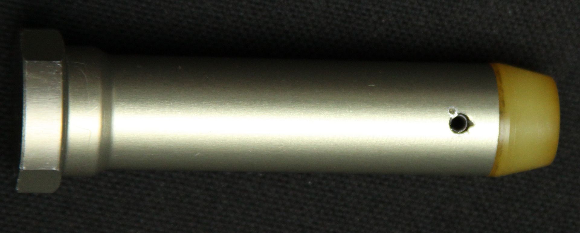

    Quote Originally Posted by Quib View Post
    Interesting.
    I’ve heard of the buffer roll pin backing out, but have yet to personally have one back out on me.
    Staking it in place is not a bad idea, and is definitely one of those quick DIY procedures that anyone can perform which will only make your weapon that much more reliable and will definitely eliminate that possibility.
    Epoxy might work as well, but I would be concerned with the chances of it eventually breaking loose or not bonding well to the buffer. I think mechanically fixing the roll pin in place through staking would be the way to go and would be more of a permanent fix.
    I may have to give a go at this, and if I do, I’ll post the results with pics.

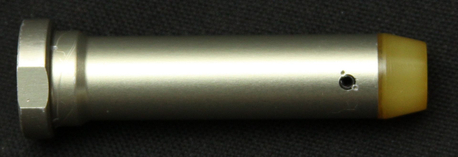

    Quote Originally Posted by cptx123 View Post
    Yes I have had this issue, how do you stake yours?
    Well since mine was sticking out about 1/8" already, I just filed that 1/8 off. Then I drifted it back so it was centered with about 1/16" on each side and staked it.
    It doesn't take much... just bend some metal into the pin hole.

    Yup, I too have seen the roll pin drift out, interfere with the buffer spring, and cause problems.
    The staking idea sounds good.
    1,100
    I tried staking an old buffer I keep as a spare. I wasn’t too impressed with the idea after I tried it.
    The buffer wall is pretty thin. So thin that I feel if too much material is removed from the roll pin, the roll pin is no longer resting against sufficient buffer material to retain the rubber bumper.
    Another draw back was the fact that after staking one side of the roll pin, when I spun the buffer over to stake the opposite side, the force of staking pushed the roll pin back in the opposite direction, pushing the first stake material outwards.
    Another viable option to a walking buffer roll pin, might be drilling the roll pin hole larger, and going with the next size up roll pin.
    Interesting point. I haven't pulled a carbine buffer completely appart to see if this is an issue. But I already had some buffers where the roll pin was so short it was beneath the buffer body on at least one end already.

    Better idea maybe-- instead of staking buffer thin aluminum over the pin, flare the pin on each side, file off excess as needed.
  10. #20
    NoVA
    10,780
    17 (100%)
    Flaring might work Ned. But the flared end would have to be no larger than the body of the buffer so that the spring wouldn't drag on it.
    I stake mine because I've had the pin start to come out. This makes it drag along the buffer spring as it cycled and then it caused stoppages. I could also hear a change in the buffer spring sound. The delrin bumper never came off at any time.
    The staking holds, I've never had a roll pin walk after staking.
