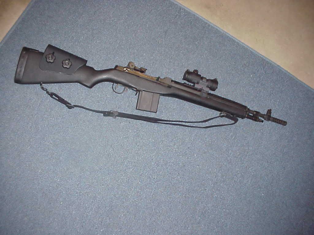

    Any optic you put on the Scout will only give you a partial cheekweld. I prefer a sold cheekweld with a .308 rifle.
    I added and adjustable cheekpad and went with an Aimpoint ML3Comp. With this setup I get a perfect solid cheekweld.

    Mauser88: is that a Karsten Camo model?
