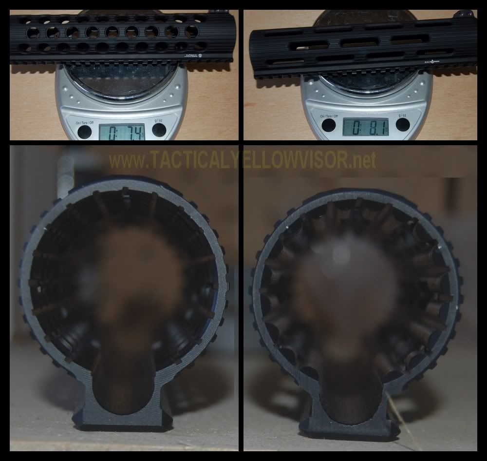

    Having a 9.0 from each in my hands I took some comparison photos. I find the difference in the wall thickness to be interesting. The picture is from the muzzle end. At the barrel nut end the profile of both walls is the same as theVTAC on the right in the picture below. The TRX rail gets thinner approximately 6" from the nut end.

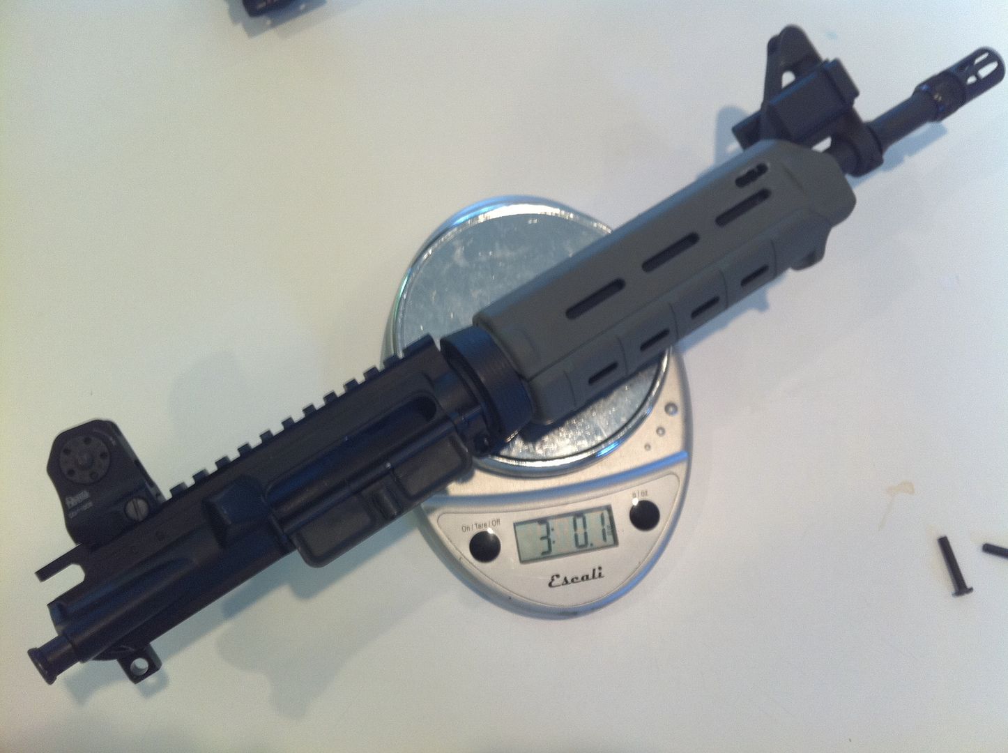

    On the subject of weight, be sure you are comparing apples:apples, and understand what you're getting yourself into with these tubes.
    One could make the argument that the VTAC 9.0 is functionally no lighter than the DD M4 9.0 rail. Others may argue that the DD rail "needs" covers which add to the weight (I don't think it does, they are very well rounded rail sections), but the counter is that the Troy tubes have no heat resistance. We can go 'round and 'round on this, but the point of this post is simply be careful what you change in the thinking that it's going to get lighter. It may not when all is said and done.
    Starting point
    Colt 6933 upper w/ shaved FSB and DD 9.0 M4 rail
    Same upper, DD swapped for VTAC
    Add bottom rail section for VFG
    you can add 2.8 oz. to each of these for DD fixed front & rear BUIS
    upper w/ M4 rail & sights 2lbs 13oz
    upper w/ VTAC rail & sights 2lbs 12.4oz
    upper w. VTAC tube, lower rail, & sights 2lbs 13.2oz
    6933 MOE upper for comparison 3lbs 1oz

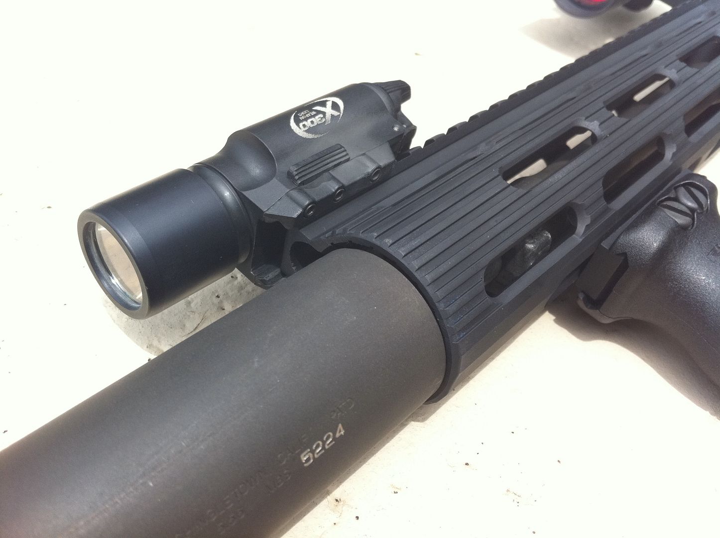

    Then there is the issue of the 9.0 Troy products being longer than other makes, which may cause issues with your other accessories.
    note the clearance for the can, or lack thereof. This was not an issue with the DD tube installed. Also the smooth transition from the Troy tube to the can means it is VERY easy to sneak the hand forward to the hot can, thereby necessitating adding MORE weight for a longer rail section and hand stop of some sort. Note also the lack of concentricity of the tube. Barrel and can are in line, as there has never been a baffle strike. Unsure if this will lead to sighting issues with irons or not.

    Wow, Rob. I think you'd reeeeally dig my 10.5"/9.0VTAC setup for the M4S.
    The lack of concentricity is my primary issue on that one - might have to open up the ID further on the bottom, it seems like it's 5-8 thousandths even after the shop had opened up the ID to 1.6.
