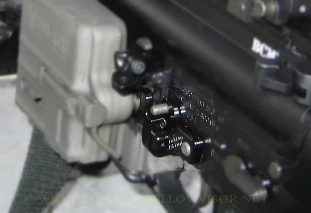

    For those with concerns about this, but that still want to achieve the lock-back feature for malfunction and other clearances, there is the Boonie Packer Redi-Catch which replaces the hammer and trigger pin and mounts to the side of the gun.
    I don't have a picture handy of the operational side, but this is the mounting side and how it interfaces with the "ping pong paddle".
