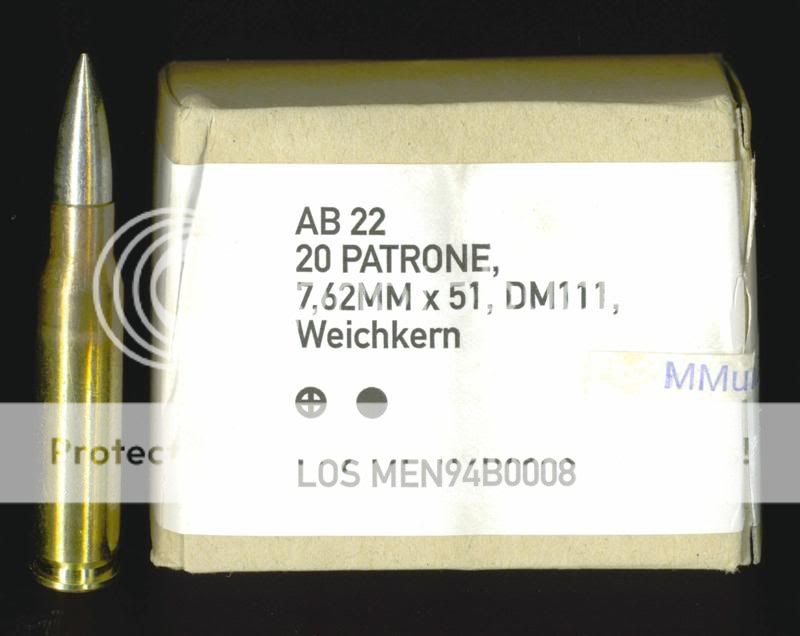

    Doc, do you have by any chance any data on the German 7.62x51 ammo?
    This is all I could find:
    Bullet design is AB22 whose terminal ballistic performance in tissue is unique from most other 7.62 NATO FMJBT Ball bullet designs. Rather than pitching up 90 degrees, then pitching backwards another 90 degrees and exiting backwards, AB22 pitches up 90 degrees then breaks into two parts at the cannelure, similar in performance to M193 5.56 NATO Ball.
    Source: http://www.afte.org/forum/smf1/index...22903#msg22903

    Wow! It seems not all steel jacket 7.62 NATO ammo is created equal... sadly the germans changed their bullets on purpose, to avoid fragmentation.
    DocGKR, what is the reason the DAG ammo fragments at much lower velocities (=extended ranges)? Thinner jackect?
    Have you tested this bullet?
    What is the bullet weight and velocity (they should comply with the NATO standard)?
    What is the performance of this DAG ammo against common intermediate barriers, compared to gilded metal clad bullets?
    It seems that bullets like this present a very cheap and simple alternative to enhance terminal ballistics in this caliber, are there any downsides?
