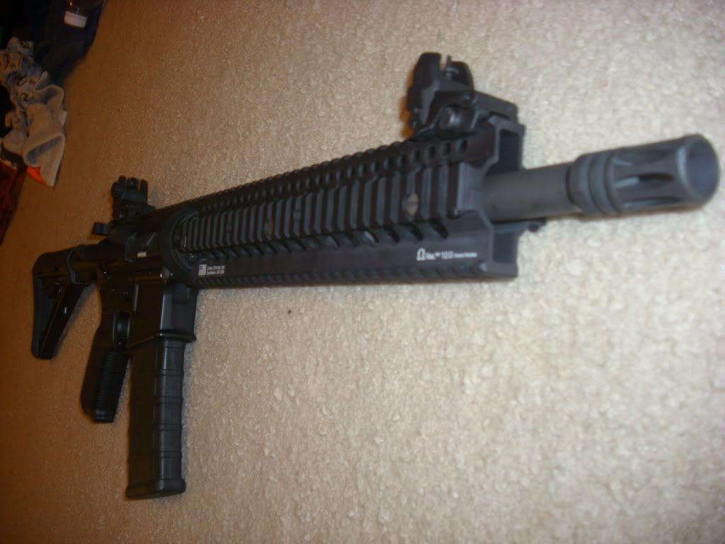

    HERE'S MINE...
    SPECS:
    –– 14.5 ADCO CMV CL 1/7 carbine gas (I know, I know) A2 FH...soon to be Surefire MB556AR brake
    –– DD Omega 12.0 w/ DD low pro GB
    –– CMMG lower w/ RRA parts, Magpul MOE grip and trigger gaurd
    –– Magpul MOE stock
    –– Magpul MBUS front and rear
