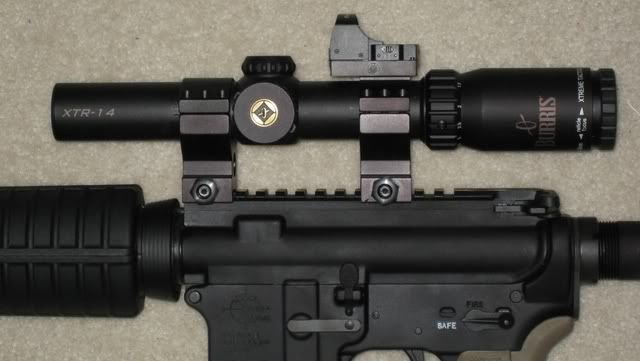

    Look closely at the following picture. It isn't my rifle, but the ring marks (to the left of each ring) are identical to what was left on my KDot. This is what I want to avoid. Normal wear is one thing, but a mount deforming/marring/whatever a scope just from mounting it should be avoidable, IMO.

    The marks on the scope above looks to be caused by having the rings to tight while pushing the scope back and forth adjusting the eye relief.
    Did you ever try lapping the rings? This can help with the scratches.

    My marks looked the same, although they were perfectly fitted to the mount in that they weren't from "adjusting" it while mounted, nor were the rings tightened too tight. Someone else suggested that those were common with horizontally split rings stressing the scope tube where the rings came together. The fact that Larue's rings do not leave marks seems to reinforce that it's the design of the rings that is leaving the marks and not installation error. If someone with more knowledge has some insight, feel free to chime in.
    I haven't tried lapping the rings. I haven't been convinced that lapping a QD mount would remove the chance of ring marks completely. If they will, it's an option. Otherwise, it's simply an added expense that detracts from the value of the mount.

    Get a mount that is one piece, not separate rings (you're relying on your rings to mount in perfect alignment separately on the rail of the upper) and get a ring lapping bar and kit.
    All my scopes had marks on them until I starting lapping all my rings...it will work on a 2 piece system, but only if you don't remove them after you lap them.
    I don't have any scientific proof, but I've also stopping having issues with scope's jumping around in their adjustment range or moving zero's in between range sessions since I started lapping rings.
    I have not however ever lapped a single ring, like what may go on a aimpoint since there's only one ring.
    EDIT: Just noticed that you said that picture wasn't of your rifle, in that case I'm thinking the bobro you're mentioning is a one piece mount - if you don't get anything else to work, I'd find someone that can lap the rings for you and try it before investing in a lapping bar.
