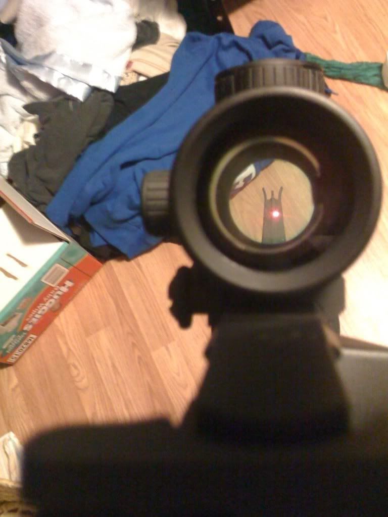

    Ok i put a red dot on my AR 15. Its the first gun i've had, just got it today.
    I put the red dot on but i cant see past the front iron sight.
    What should i do?

    You need to get a bit of elevation off of the rail with the red dot sight mount (riser mount, rail spacer etc). Keep both eyes open. Get yourself some rear sights.

    You need a riser.

    ^^That. From what the picture shows, your optic is right on the rail. It needs more altitude, therefore a riser if the rail interface is integral to the optic. Otherwise, a 1/3 or absolute co-witness mount for the optic if the current mount isn't integral.

    You need a riser. But I wouldn't bother since your Tapco sight will break very quickly. If you wan't a budget optic go to Primary Arms.
