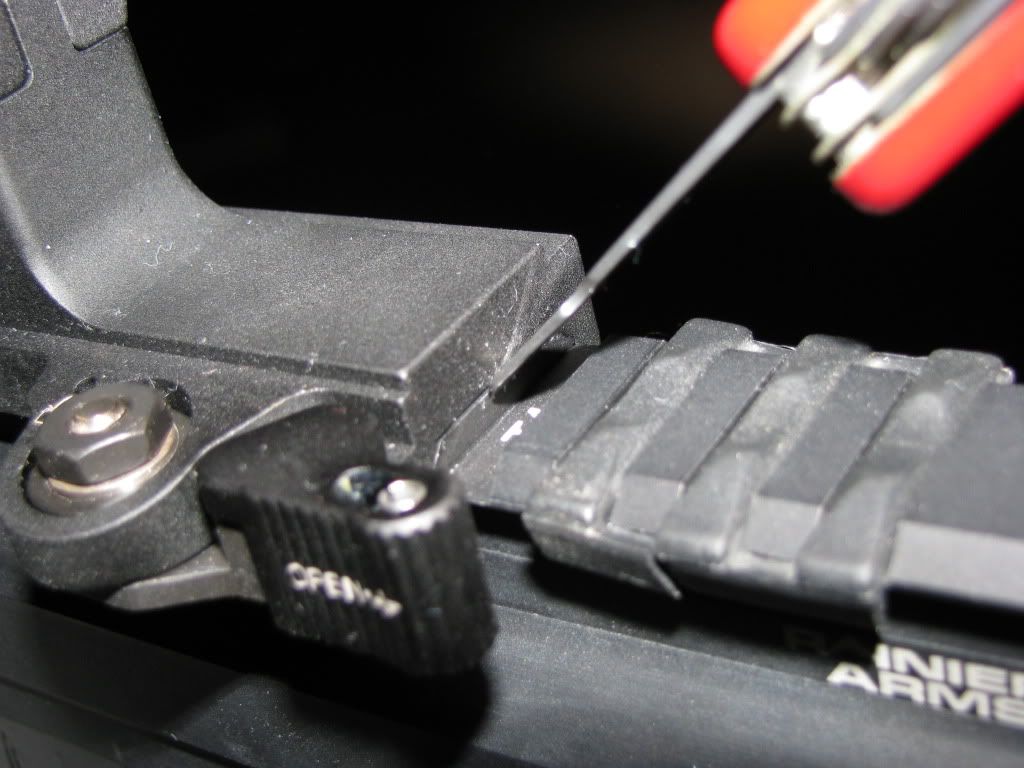

    Anyway I got some pics up.
    In this pic, I pushed the mount all the way forward so the recoil lug is pushed against the forward rail gap. Note how you can see the ledge it creates how the letter open catches on it.
    Next I lock the bolt back and sent it home twice. Now notice that ledge is gone and the letter opener cant catch on it anymore.

    So is it just an issue of me not tightening it enough? Its already tight on to the point where it marred the anodizing off the rail pretty good.

    Tightened it down another 1/4 turn. Still occurs.

    FWIW my Larue T-1 mounts do the same thing. They are adjusted VERY tight.

    Because I doubt my mounts are defective in anyway. I have a brand new SPR mount and a older T-1 mount and they both do the same thing on different receivers. I think its just something Ill have to live with. The slight movement probably wont affect zero so w/e, I just wanted to see if this was an isolated incident.
