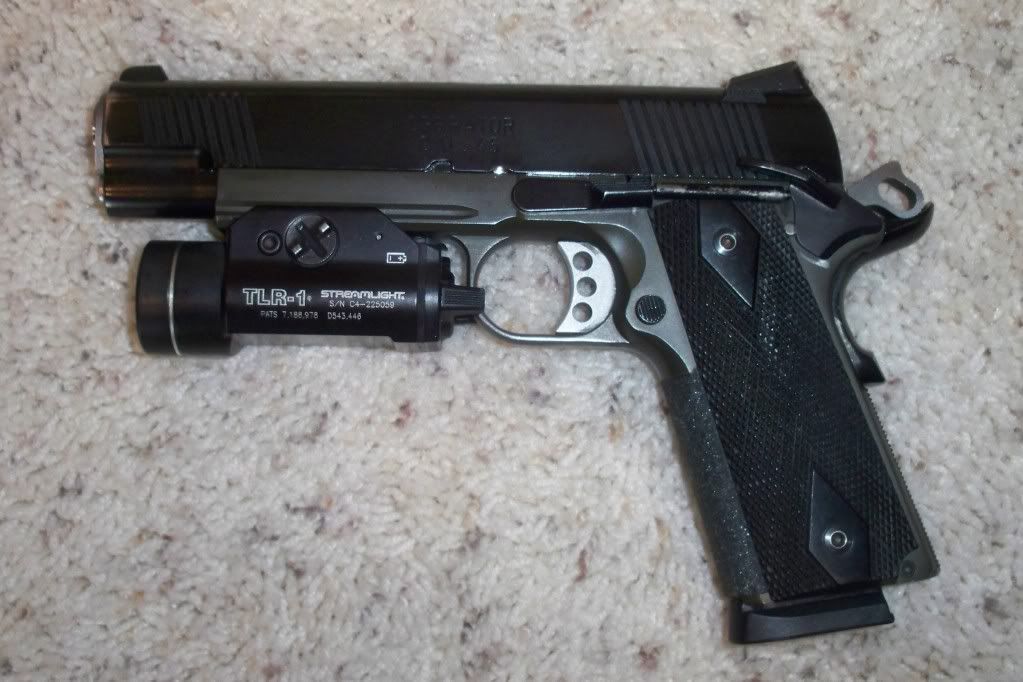

    I'm a bit late to this thread but I'll throw in my .10 cents anyway.
    I pondered hard on the the Kimber Warrior series and the Springfield MC Operator pistol. I chose the MC Operator out of sheer availability of the weapon. In other words it was sitting in the case at my gun dealer one day and I wasn't going to walk out without it tucked under my arm.
    They are hard to come by now aday's. Even Gunbroker doesn't have any at the moment and one can usually find just about any Springfield @ GB if your willing to pay a slightly higher price, sometimes. There are no TRP Operators currently in their auction.
    The gun is superb for the price of $1250, which is what I paid for mine, less a small trade.
    It has run reliably out of the box and I"m currently just across the 1500 round count mark with no mal-funks of any kind, none, nada, zip. I have fed it everything known to man in the .45 ACP genre of ammunition and nothing has stopped the MC Operator from eating and spitting out it's dinner. The accuracy of the weapon is far better than I am. It's the first pistol that I have shot hole for hole with. No, I'm not a super Jedi type shooter. With the MC Operator if I just stick to fundamentals it shoots groups that I have never been capable of shooting with any other pistol.
    I recently recieved my MC Operator back from the SA Custom shop. I had the front strap checkered (hand) in 20 LPI and the blended S&A magwell installed. I purchased black VZ Operator II grips and used the hex screws. The SA Custom shop also refinished the frame in the factory Armor coat (OD green)
    It is now one beautiful piece, but that 20 LPI checkering is a bugger to shoot all day long. It's supposed to be.
