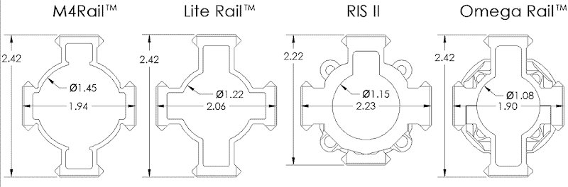

    I have a question on this. I know that when people talking about the rails being milspec they are talking about the dimensions on the individual rails.
    I see this pic on military morons -
    They are comparing a VLTOR upper to a LMT upper. You can clearly see that the overall dimensions of VLTOR upper are wider than the LMT. When it comes to the overal dimensions what is considered "milspec"?

    That is only the dimensions of the rails sections. I am talking about overall width.
    I found this comparison of DD rails here -
    Is there a standard or norm on the overall height and width? There is a fairly recent thread in which the OP is asking if a LaRue rail is worth the extra money over a YHM rail and one thing I saw several user complain about in regards to the YHM rail is that they are wider than the LaRue rails which made wrapping their hand around them an issue.
    You can see in the comparison pic and see the VLTOR is much wider than the LMT and was wondering about having issues gripping it.

    You asked what dimensions are "mil spec".
    Those are the only dimensions that are "mil spec".
    If you want to know what width rails are used by the military, then the KAC RAS and DD RISII are a good place to start.

    Actually I was asking if there is a "mil spec" that included the overall width and height, not just the rail sections.
    I measured my LaRue and it comes in at 2" wide x 2.120" wide. I wonder how the VLTOR measurements compare.
