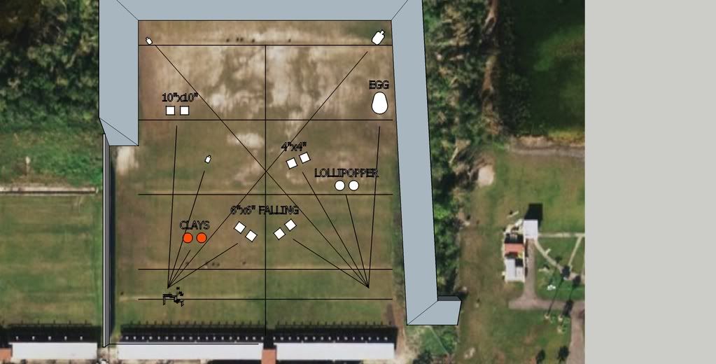

    These images may give you some idea as to what we were doing, if it matters.
    Stage 1 was to the left, lines indicate targets to be engaged from that stage. Firing line in this case was the 15 yard line, with the steel target in the upper right being past the 100 yard line.
