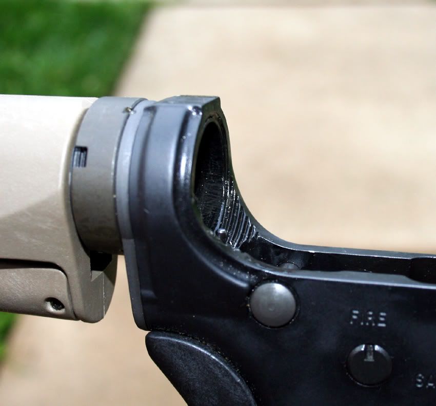

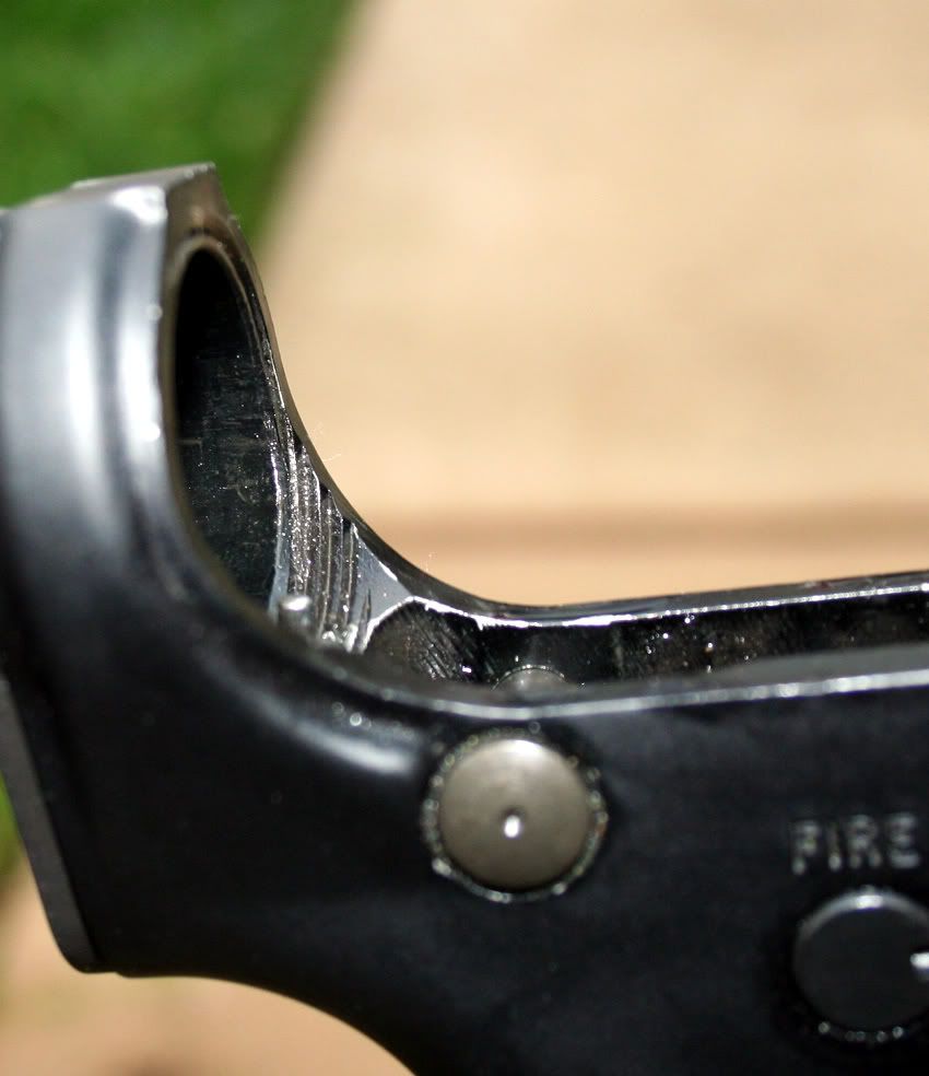

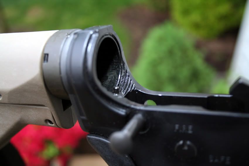

    It's hard to see it from the pics but the VLTOR does have a 'lip', the lip consists of the entire 1/2 of the threaded end of the tube. Here's some pics of 2 different lowers with VLTOR 5pos tubes. The lip is just less than 1/16" longer than the top edge of the tube, you can see it in the pics a little better on my wifes lower.
    My Bushmaster 3gun lower.
    My wifes Bushmaster 3gun lower.

    Thanks for the pics. I see the lip. What is it's purpose? And I hate to be a pain but any chance to see pics of the exterior of the tube, like how the finish matches the receiver? Thanks for the help!

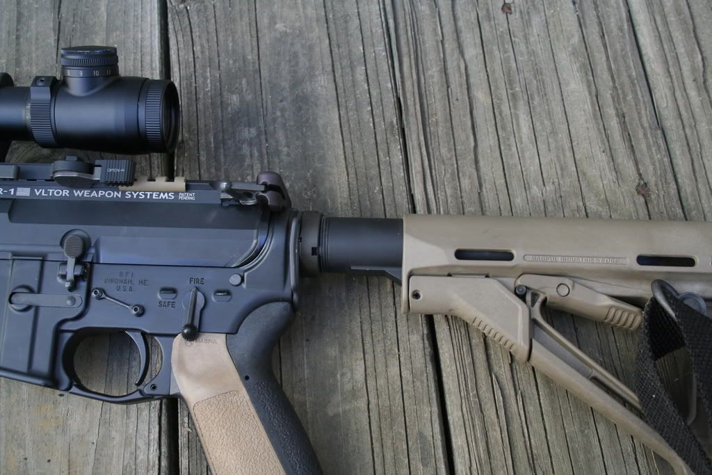

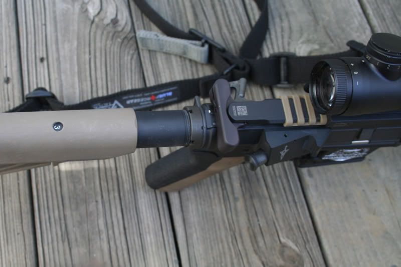

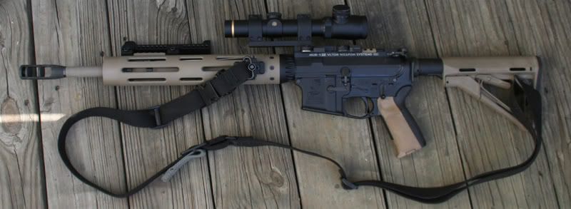

    Here are pics of my Vltor club foot model kit with Vltor tube and hardware.
    Vltor's finish is very black, the best I've seen on most buffer tubes.
    It matches my '04 model Colt 6721 upper receiver but not my lower, my lower is a very dark gray-black which is a normal AR anodizing mismatch that all the makers have.

    Nice rifle! And, thanks for the pics of the match between tube and receivers. That's what I was looking for! Anyone got pics of the others? It looks like the VLTOR may be the way to go!

    The lip holds the buffer detent in well. On cheap or old CAR recevier extensions you sometimes had to trim down the top edge so that the upper would close on the lower. If you didn't and didn't have the receiver extension on tight enough the buffer detent and spring would auto-eject inside the lower. VLTORs finish is a nice deep black.
